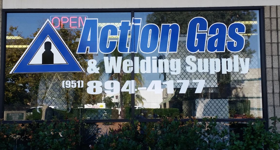

Attached is a picture of the store front I am to install cut vinyl on. I want to go over the bars with the vinyl. I am wondering if any of you might have a video of how that is done. We do it one way, but I think there might be an easier way. Any guidance would be appreciated.

I would consider a design that does not cover the mullions. No matter how you do it, any text or recognizable image will distort when viewing the installation from any angle other than "straight on". If you can limit your text and images to spaces within the window, you can cover the mullions with material that matches the background (if needed, probably not recommended).
Practically speaking, the human brain will process an image separated by mullions as a continuous image, despite the "bars" interrupting the image. It's only when the designer tries to be tricky that it calls attention to the incongruity. The harder you try to hide the mullions, the more they will stand out.
Notice how hokey "PROPERTY MANAGEMENT" looks in your photo. It takes the brain a few seconds to decode this segmented message. Do the letters really need to be that big? Most storefront windows like this are for pedestrian traffic walking up to the entrance. Typically, there is a main sign on a sign band above the windows that is intended for longer range viewing. If this is not the case in your situation, and the business needs a large image or text to reach a long distance, I would re-evaluate the appropriateness of the location for the business. If it is a destination business, smaller signs on the windows will work fine (the customer is going there anyhow - they just need to know they are at the right place). If the business relies on impulse purchases (Property Management would not be considered an impulse purchase), a properly designed storefront that allows for appropriate signage is essential.

when we do windows we just dont cover the mullions you can still read the sign just fine. We always cut decals back a little away from the rubber molding around them

I do full storefront window per and do not cover the mullions. I have text span 4 windows sometimes. If you want to see an example PM me.

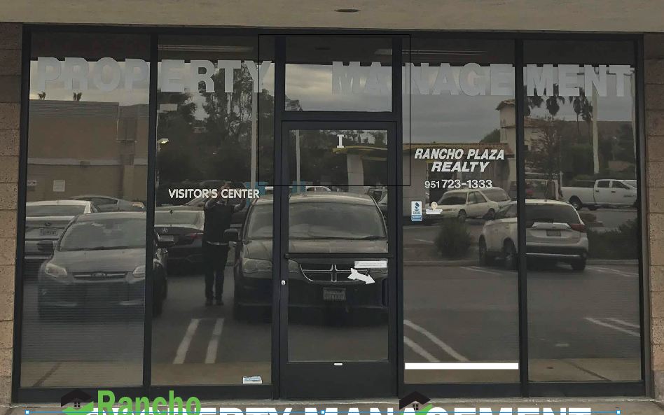

I have attached a sample of vinyl over the mullions. I think it looks a hell of a better than the artwork being seperated. I don't know how it is in Illinois, but here in California, going over the mullions is now becoming the new standard.

Good job on the mullions, they look weird. And whats up with the white outline on the bottom of the triangle?

I'm about to do 37 windows on a large liquor store, full coverage. Will not be wrapping mullions. Never have. I have had to remove old graphics from them from other people, total pita.

The only way to do an installation of vinyl that covers the mullions would be to have extra letters to go over the mullions, at least if the sides of the mullions are covered, not just the tops. And one problem you'll run into then is the vinyl not matching up where it goes from the window to the side of the mullion if there are curves and angled lines there.
If the vinyl is only on the top of the mullion, it would be a really fiddly installation, necessitating cutting the strip the goes on top of the mullion first, applying it, then putting the pieces remaining on the windows to either side. And it will only look right when viewed from directly in front as in your photo.

Anyways, problem at hand. The solution is simple, you try your damnedest to talk the client out of it! If that fails you print the mullion areas separately with however much extra material you need and charge a premium for the hassle.
