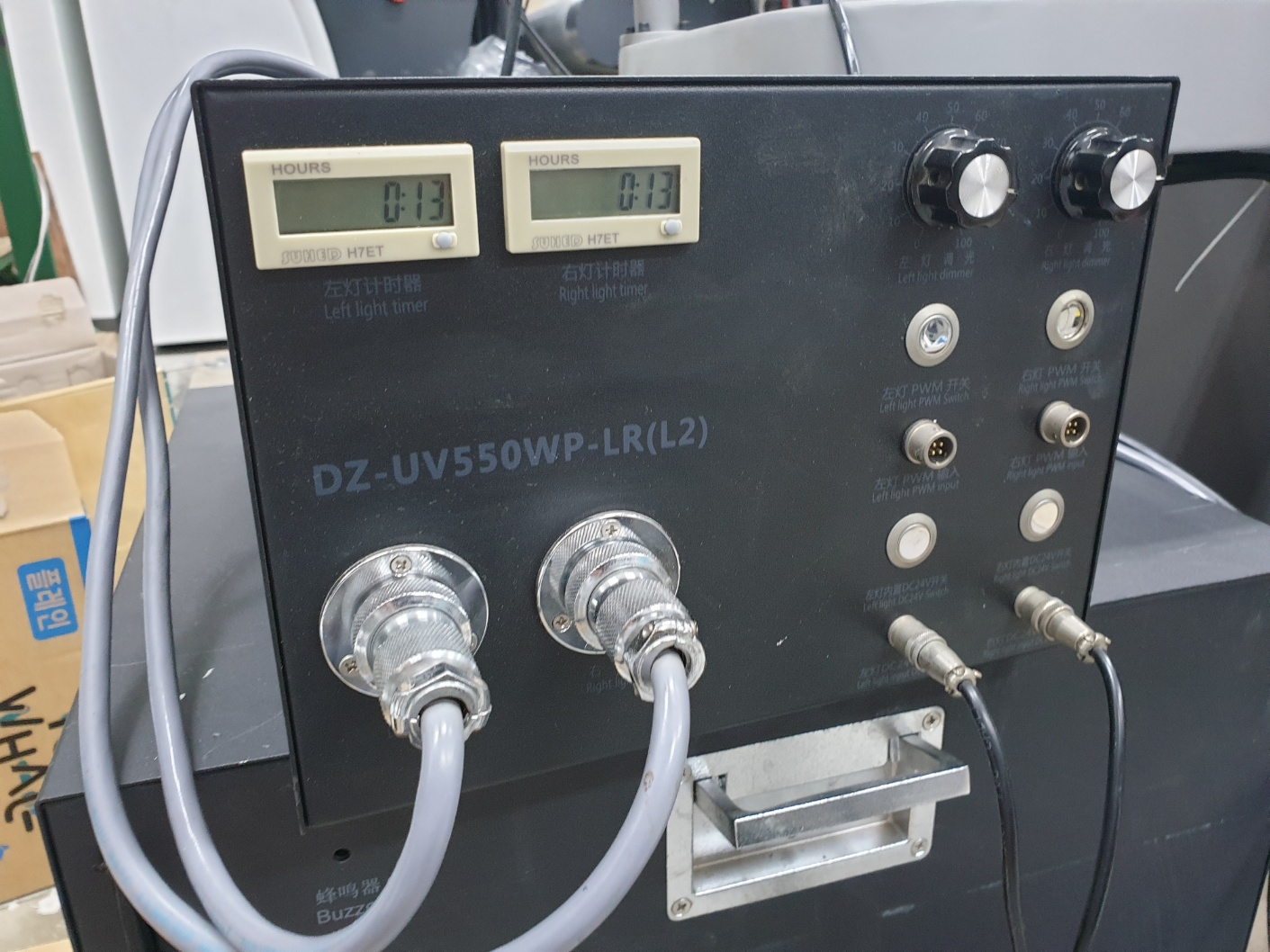

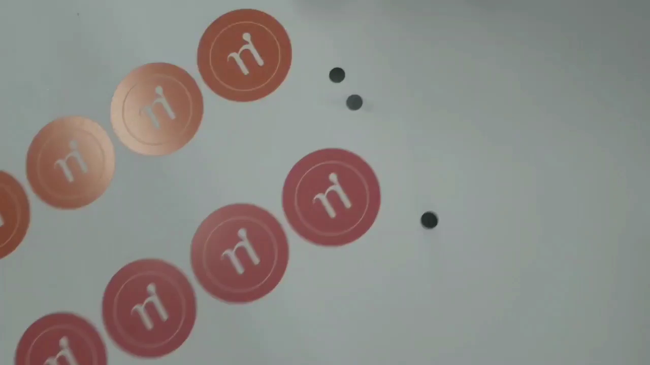

When I set the lamp setting value to 100% and printed it out and touched it right away, it was not completely cured. If you dry it for about 20 to 30 minutes and rub it, it hardens well and is difficult to erase, but if you erase it with water, it erases like this. (capture5)
Is it the UV lamp or the ink?
Ink is well past its expiration date.

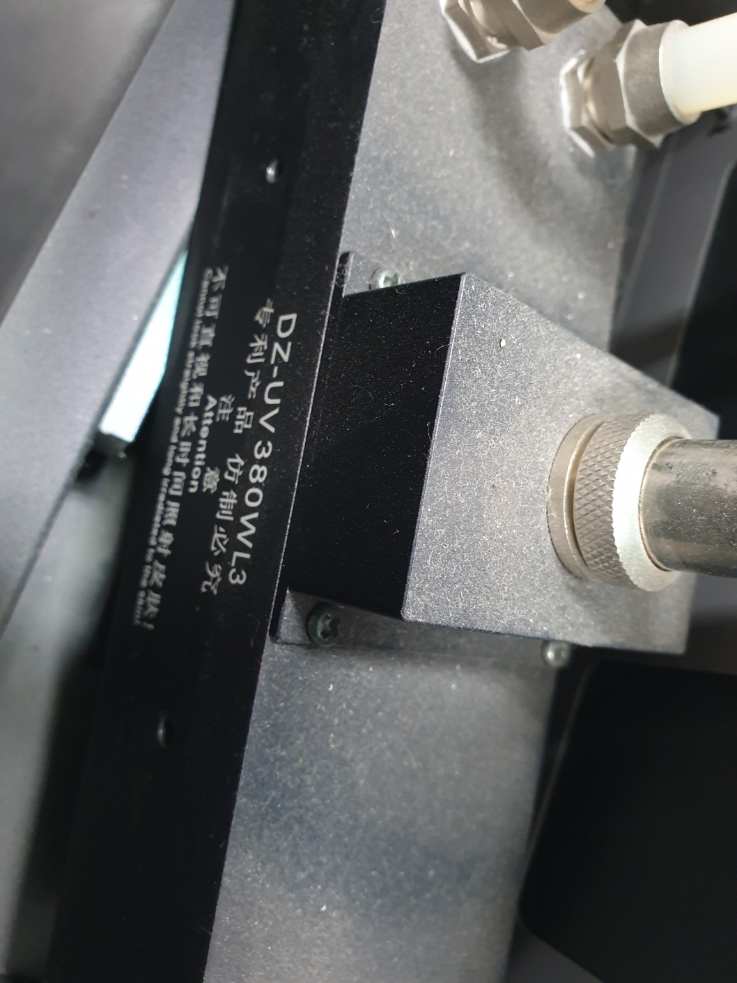

If you are considering buying a new UV lamp, should you buy the same model?
I wonder if there are any products that have been upgraded a little more
(The model is handtop 2017 HT1600UV.)
During printing, the UV lamps are all lit when viewed from below.
Does anyone know of a similar problem or solution please tell me?

If your unit uses bulbs, then yes they likely need replacing every 6-12 months. The newer LED versions have a separate unit that cools the unit and controls intensity of the lamps - so if you have a LED lamp unit, lamp intensity is likely set too low.
Water should not dissolve cured UV inks; neither should Windex; but either Isopropyl Alcohol or Denatured Alcohol will (especially if allowed to soak for a few minutes).
How many hours are on your lamps ??
Are your fans operating correctly ??
Normally inks won't dry 20 minutes later, if they are UV cured, unless you'd take them outside in the sun for 1/2 a day.
Expired ink is not a good idea, either. Most inks have a shelf life of about 2 years.
AlsEU
In UV printing initial curing and polymerization give around 70% of the mechanical resistance, but secondary polymerization may last up to 24 hours after printing. If the lamps are old (and therefore weak), the ink won't get enough light to cure correctly (especially the layer closer to the substrate) and the ink adhesion may be affected. I would start with the new lamps.

Is it okay to use other company's lamps as long as they match the standard and capacity?

Your ink is expired by 2 years yikes - Huge problem right there. When using expired ink you'll get all kinds of issues. You need to flush your lines out & install new ink.
There are two filters types on that machine correct ?? Change all filters as well, these are recommended at 6 months intervals - This can cause spotty ink issues & flow problems.
Change your ink first & than run a test. On that machine your ink will be cured 100% right off the machine.
Do the ink first, The LED lamps last a long time - Shouldn't have to replace these unless machine was damaged or ran like crazy for a few years.

It is difficult to replace the lamp.
Is it okay to replace it with the same option with the same specifications?
Or do I really need to use lamps of the same product?
Not a opinion this one is fact - If your ink is expired by that long its not gonna cure properly & the ink wont spray correctly. Ink first & Than trouble shot other issues.
Handtop sells the correct lamps for your machine, just contact them - they can also provide the correct ink & cleaner for your machine.

I am late to this party so you may already have your solution. UV lamps do not have a shelf life, Anyone telling you same is providing fake news. We manufacture UV lamps, what you are describing does not sound like a curing issue rather an adhesion issue. Depending on the ink laydown, you may be experiencing surface cure without depth of cure. Elevated surface temperature may be due to absorption of infrared from UV bulb. This would be more of a problem with dark colors. More than likely the issue lies with the ink -- ink substrate adhesion. If your UV unit has a quartz plate, check and clean to remove any ink.
