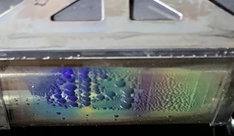

I have a Mutoh valuejet 1324. It’s dropping ink (cyan) after a couple feet of printing. Is it time to change Dampers? My nozzle checks are 100% perfect and the Printhead is 5 months old.

Dampers area consumable part of the printer. Depending one how much printing need to be done in certain intervals.
FatCat
How old are the dampers?
Did you not replace dampers when you installed the new printhead?
Long story short, if the dampers are more than 1.5-2 years old I would change them.
Netter26
The dampers were replaced with the printhead and maintenance station is 6 months old. I slept on it and replaced the dampers this morning. All is good Now after the first couple feet I tried. I just thought 5 months was a little soon to replace them. Thank you for the advice!
