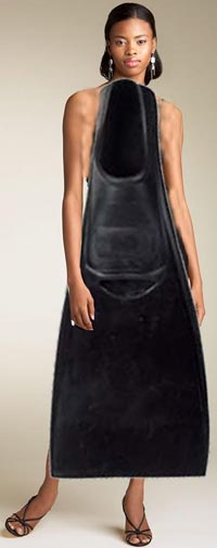

30 seconds to auto trace in Corel... but, as always, the results are unacceptable because of the poor quality of the jpg (jaggies).
For me it was a 3-4 minute hand draw because I am too sloppy on the 1st pass and have to go back and tweak the nodes.
If you are going to be in the sign business very long you need to learn how to use vector illustration software (Corel, Illustrator, Inkscape, etc...).
Redrawing this dress (ignoring any copyright issues) is a basic task and learning to do it is worthwhile.

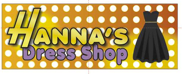

I like to take these things and make lessons for my wife to use (she teaches HS graphics)
Here is the "Dress Shop Sign"
