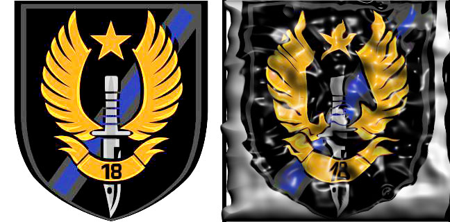

It looks like some sort of Eye Candy effect.
I've got an old version of Photoshop (6.0 I think) that has Alien Skin Eye Candy and I used to play with the effects all the time. You can do this effect by copying a design layer and playing with the Bevel settings in Eye Candy.
Here's a 30 second render using Eye Candy ripple, then bevel. (Original image at left, Eye Candy on right) With a little time and experimenting you could probably recreate a very similar effect.
