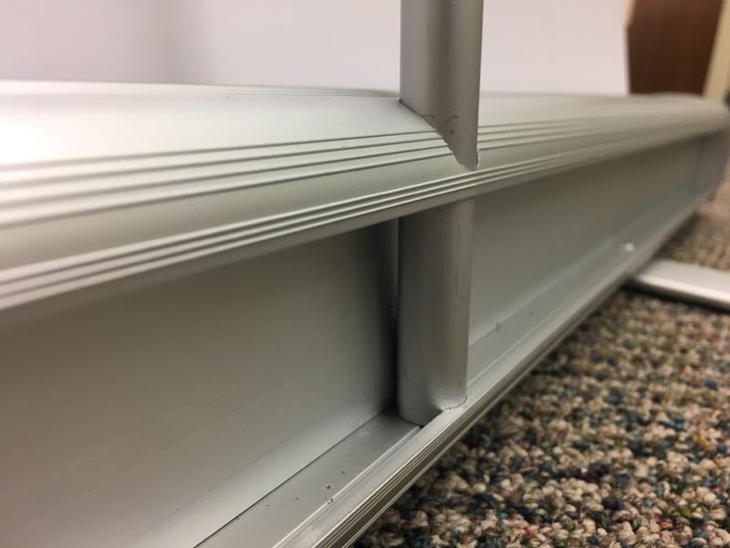

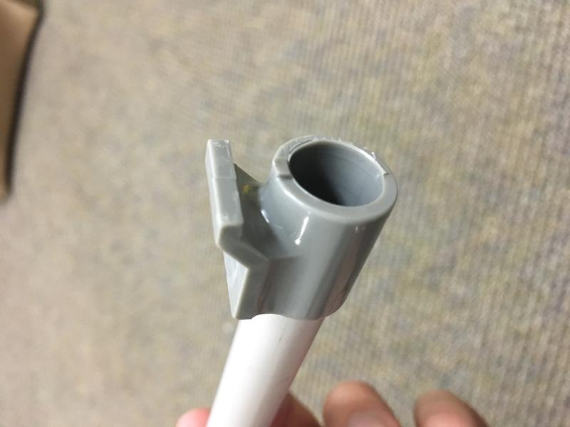

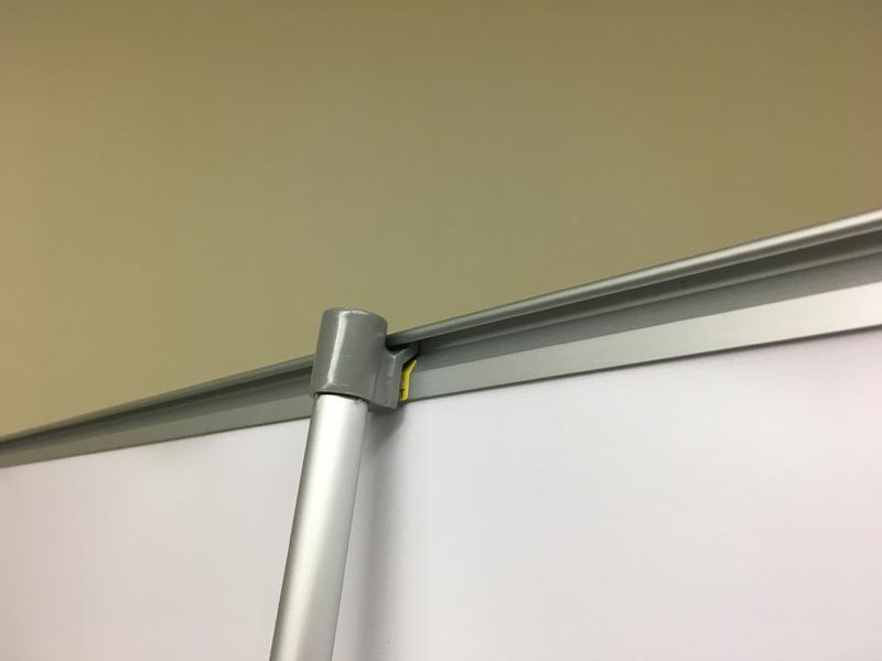

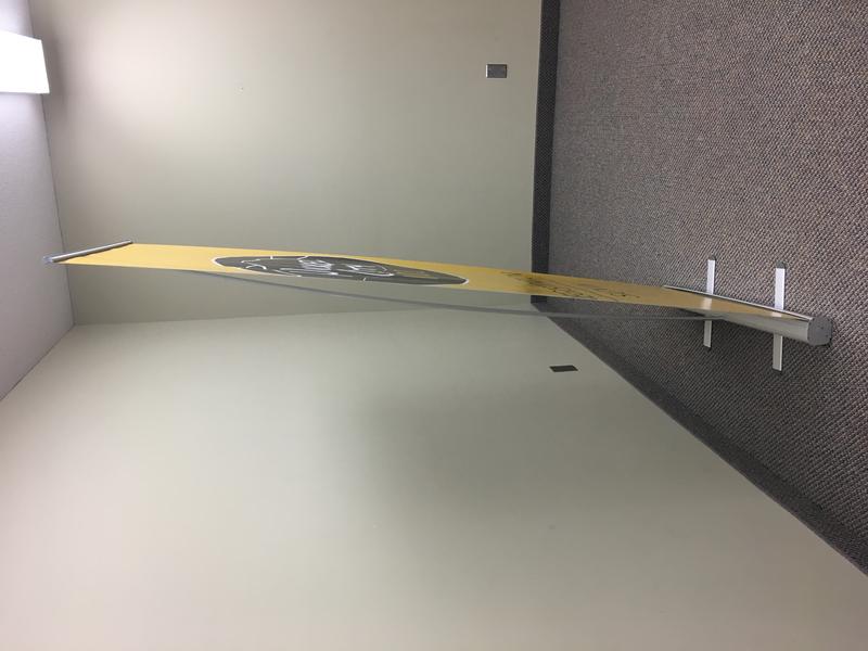

He replied back with detailed photos. Will this help? MEasured pole length is 81 11/19"

T_K
You could have him try rotating the pole. If the pole has become bent because of use, rotating it 180 degrees might straighten it up.
TammieH
Its obvious, the pole extends from the front of the base, naturally being top heavy the banner is going to lean forward while sitting on a soft surface like carpet.
The only thing you could do is add a couple spacers to the front of the feet.
alexyoon.gaius
Is it possible there wasn't enough of a leader on the bottom of the banner?
Looks like banner is too short which is adding unnecessary tension. Just a thought.
The banner was given enough bleed before put into the bottom. Thank you for your suggestion though!
Thank you for your help! I had him to place some spacers as you suggested.
alexyoon.gaius
Yes I told my customer what TammieH suggested. Since the product was shipped out to another province I can't be at site to fix it for him... that was the hard part! But I appreciate everyone's opinions on this! Thank you!
