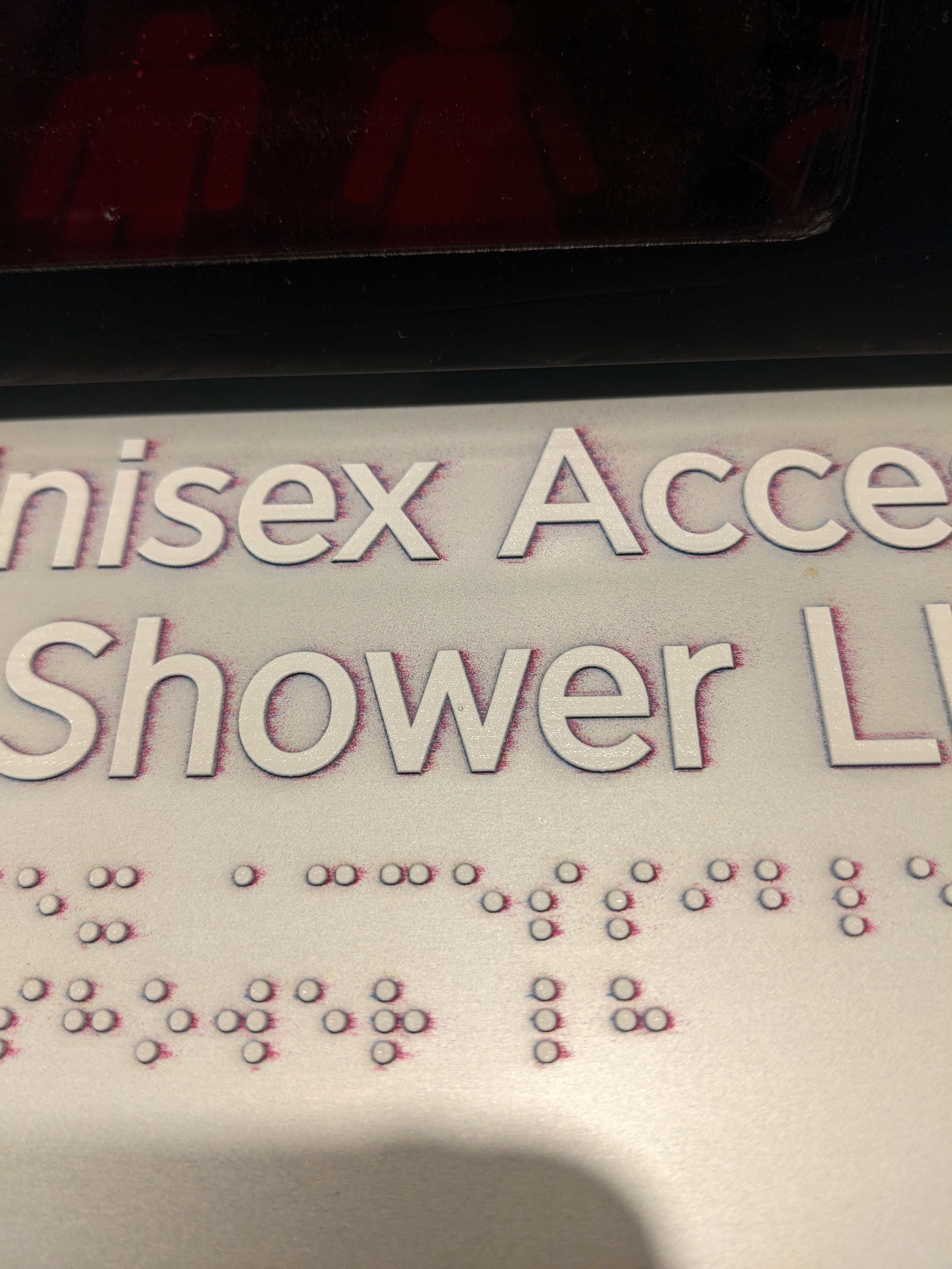

Printing braille on the ujf, and as I am building up layers (overprint x9) I'm getting this ghosting/overspray.
Is this cause to check the alignment of the heads?

I've adjusted the bed for the thickness of the media and head height is 1.5mm
I'm trying a differnt option to adjust the height of the table half way through the layers to assit in maintaining the 1.5mm depth

If it is alignment related, you can always check by running something unidirectional and see if the problem persists. If it's fuzzy in unidirectional, I'd think it would be static related. If it's clearer than I'd look at alignment.

Yep. 9 on uni.
Hence my question why the overspray is on both sides of the lettering
