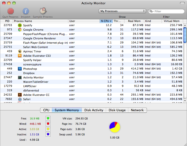

Try opening up activity monitor to see how much free memory you have, which process is using the most of your CPU, page in, page outs, etc
You can google all of the terms/data on the attached screenshot to see what they mean and maybe help narrow down the issue
Also restart and see if the problem persists. If it does, maybe a program is using too much memory or it is not being released and you are using "hard drive" memory (virtual) instead of actual memory.
Also login as a different user and see if the problem persists
I use a 6 year old mac and don't run into the issues you are describing unless you are working with overly complex vectors with too many effects

Thank you going to try looking at whats running after my designer leaves and will have him let me know what develops.

As well I checked in Activity Monitor and there was only 3.6GB active, and LogMeIn was largest at 10%
