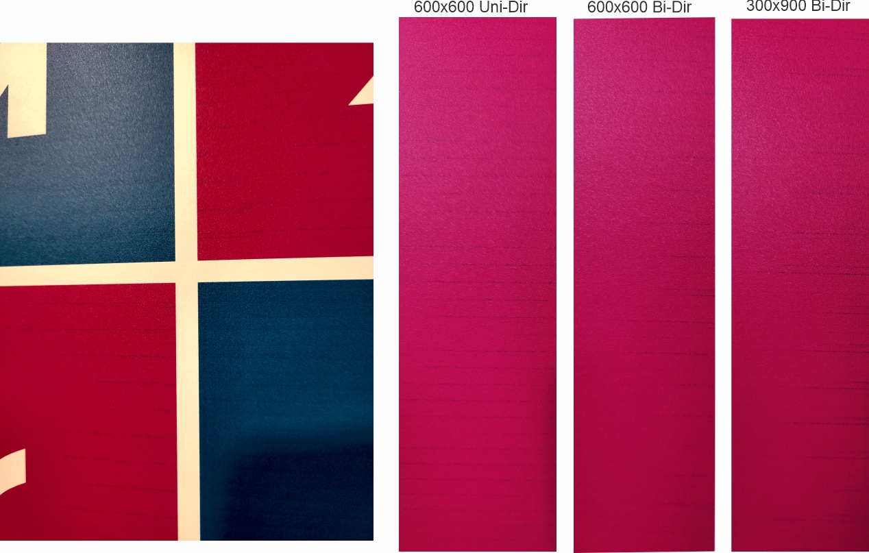

Print quality went from fine for 2 years to super inconsistent and constantly having drop out, ink starvation and contamination, banding, streaking etc.

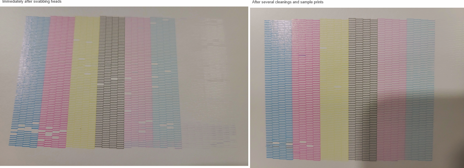

I replaced captops and did a million air purges a couple months back and it's never been the same. Our nozzle check is now almost back to normal in terms of nozzles firing, but still getting lots of contamination between channels. (You can see the color mixing in the test prints)
We'll get it to a point where it's printing normally then it randomly starts banding and streaking without any real cause.

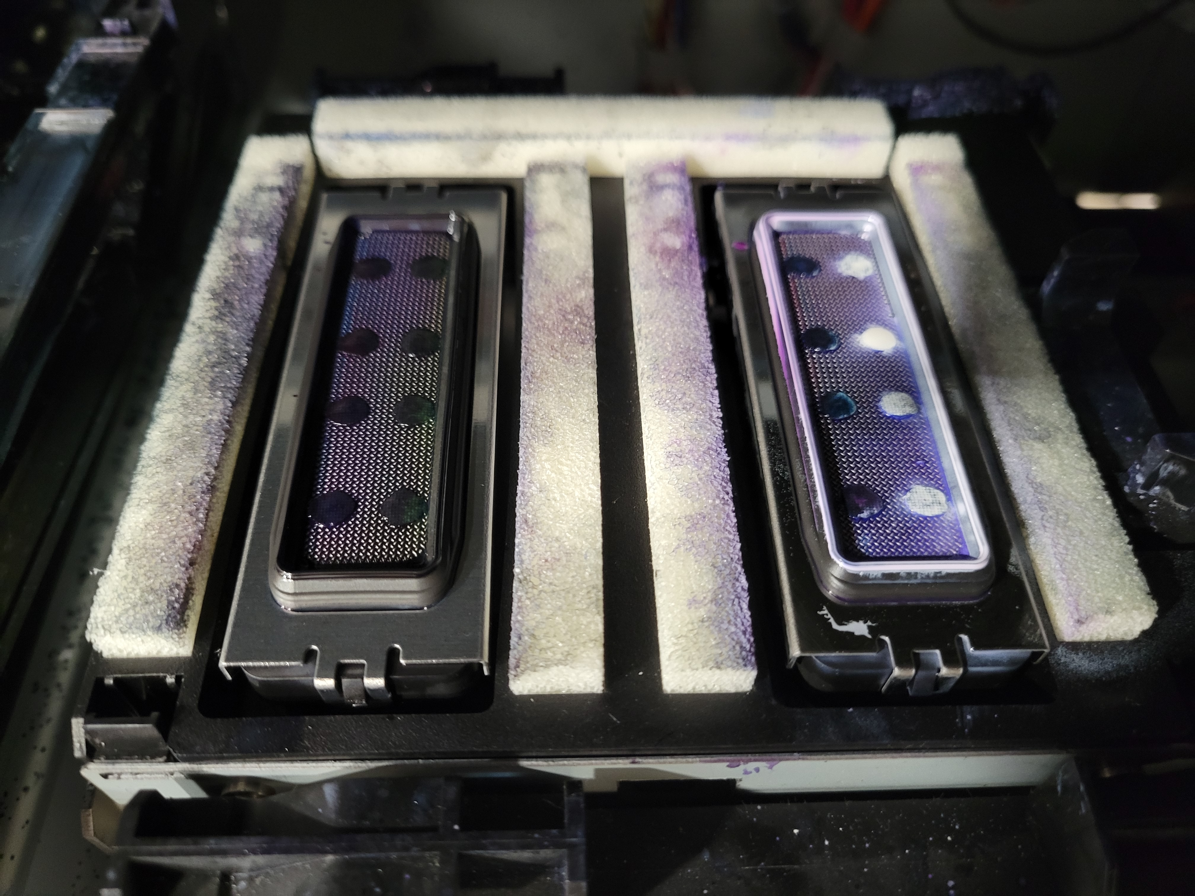

I've attached edited pictures with some examples as well as how the heads look after they've been parked - I don't think they should have all that ink pooling under heads. I edited the colors in the pics quite a bit to exaggerate the contrast on the streaking but hopefully it helps. It seems like it's only streaking when going from right to left given how much the pattern changes when going from Bi-directional to Uni-directional with the same profile. It's also not consistent across the media - it's usually much worse on left and right edges of the media and almost not there in the center. (That's the real kicker)

The first thing I'm seeing in your 3rd picture is a ton of ink left on the bottom of the head. It's almost like the wiper isn't wiping. Take a good look when the machine cleans and wipes the head and make sure it's making contact. Your head surface should have some ink on it most the time but what I'm seeing in that picture is way too much and especially over the nozzle area. The ink has to try to shoot through that ink which will cause issues.

That does appear to be a lot of ink build up on the head. Probably why you see contamination in your test prints. I would check pos and negative pressure as well and check to make sure your head is sitting properly on the captops otherwise you can make adjustments. I think I have that info somewhere. Just send me a message if you need it and I'll look for it.

If you have a foam swab, I would dip it in cleaning solution and wipe the head of all that ink

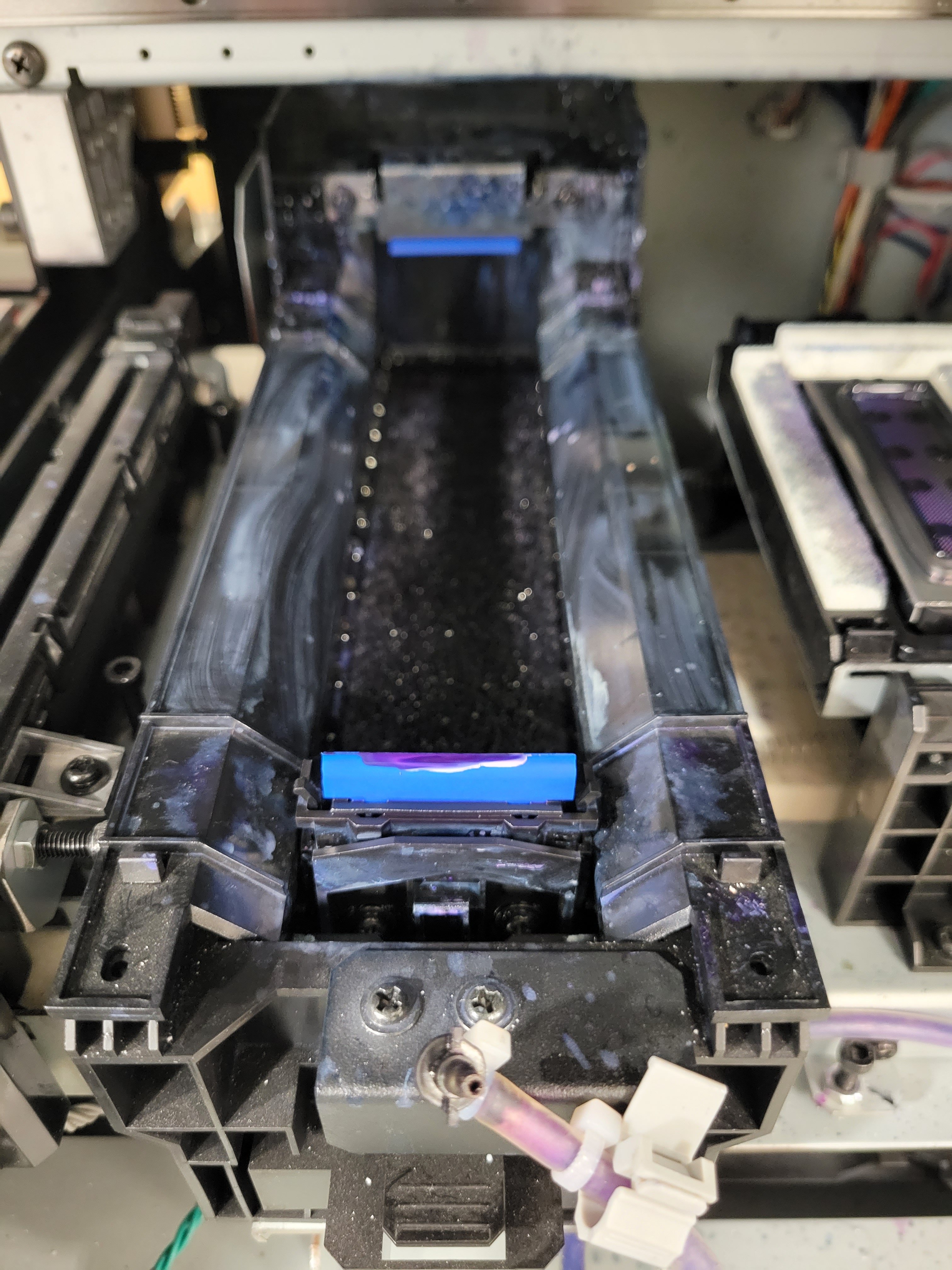

Thank you for this - I checked and the wiper is definitely not making contact with the heads or the rear wiper/cleaner.
I thought maybe the wiper itself was the issue so I swapped it but it's still sitting too low.
Is there a way to adjust the height of the wiper assembly?
Looking back on my maintenance log, I think all these issues started back in September right after I changed the wiper. I wonder if I shoved it in the there too hard or something.

I'm not sure how to adjust the height of the wiper assembly. However, make sure that wiper is in the slot correctly and clicked in. I think if its not slotted properly it gets seated too low. So I would remove the wiper and place it back in.

Raised the wiper, got it making contact with the heads again and got the nozzle check back to 100% for the first time in months.

Still very much confused as to how suddenly the wiper would be sitting lower, but who knows.
