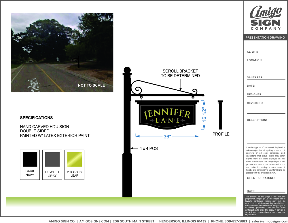

A friend of mine lives in a very nice lake neighborhood and asked for a replacement for the sign they have marking their drive/road.
This is what I proposed to them and they love it. But now I'm not sure how to fabricate it. I'm mainly concerned about the sign panel itself.
How would you fabricate this? Keep in mind, this will be hand carved HDU. Would it be ok to use a solid piece of 1.5" thick HDU on a sign this size? Or should I laminate? What material would you use for the top pieces? What hangers? Etc.
I know these are newbie questions, this is the first hanging sign I've sold in my little hand-carved sign business. I want to make sure it lasts!

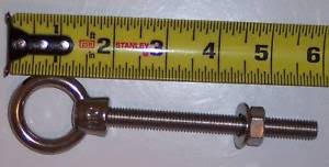

Phillip, you can use 1.5" or 2" HDU to construct this. The top pieces would also be HDU and glued in place with an appropriate HDU glue, Gorilla Glue or an epoxy. For the hangers I would use 5/16"x6" SS eye bolts threaded directly into the HDU and then fill any voids with epoxy. If you really wanted to do the ultimately secure job, then you would construct an internal steel frame, create two single sided panels and glue them together encapsulating the steel frame. The eye bolts would be welded or bolted internally to the frame. You can get by with using the typical 15# HDU but a heavier product, 18, 20, 30# would be better. Another good mid-level way to construct this would be to use the 1.5" double sided panel but place a single steel bar across the top of it, which you could bolt your eye bolts to and then glue up those top trim pieces to encapsulate the steel.

You could go with threaded rod and eyebolt.

Something like this but I would go almost to the bottom of the sign and router out a pocket for a piece of flat stock.

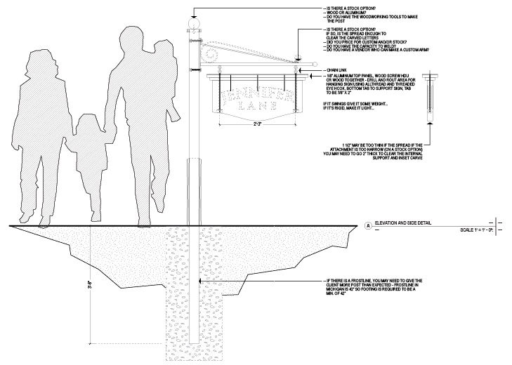

It is a very nice design... since every sign like this has a code, is it designed to the municipal code for this area? Are you installing? If so, does that require a permit and contractors license - well in your case, local registration? Overlook this and you are buying the sign...
When I design a sign for other shops, I do not put too much detail on fabrication because not every shop fabricates and installs the same. I am working on 3 signs right now where the install is so tricky, I had to get the fabricator and installer together to detail out what needed to be done prior to engineering. It's not always a slam dunk when it comes to designing details. Though it is different when you are the one building it, the lesson learned will be when it cost twice as much to fabricate and install as anticipated.
The few things I notice about the suggestions and current design is that to have an internal structure, you may need to make the panel thicker in order to clear the inset carve.
Frostline - I did a boo-boo, if the sign is in Illinois, and there is a frostline, it's 40"
Are you looking for a stock option on the frame? Do you weld or know a vendor who can make a custom frame with the eyebolt spread you need?
I included a .pdf of things I would have considered before pricing it out.
Without knowing all these tiny details, one of these items overlooked can blow the budget... I've done it myself... designers beware...

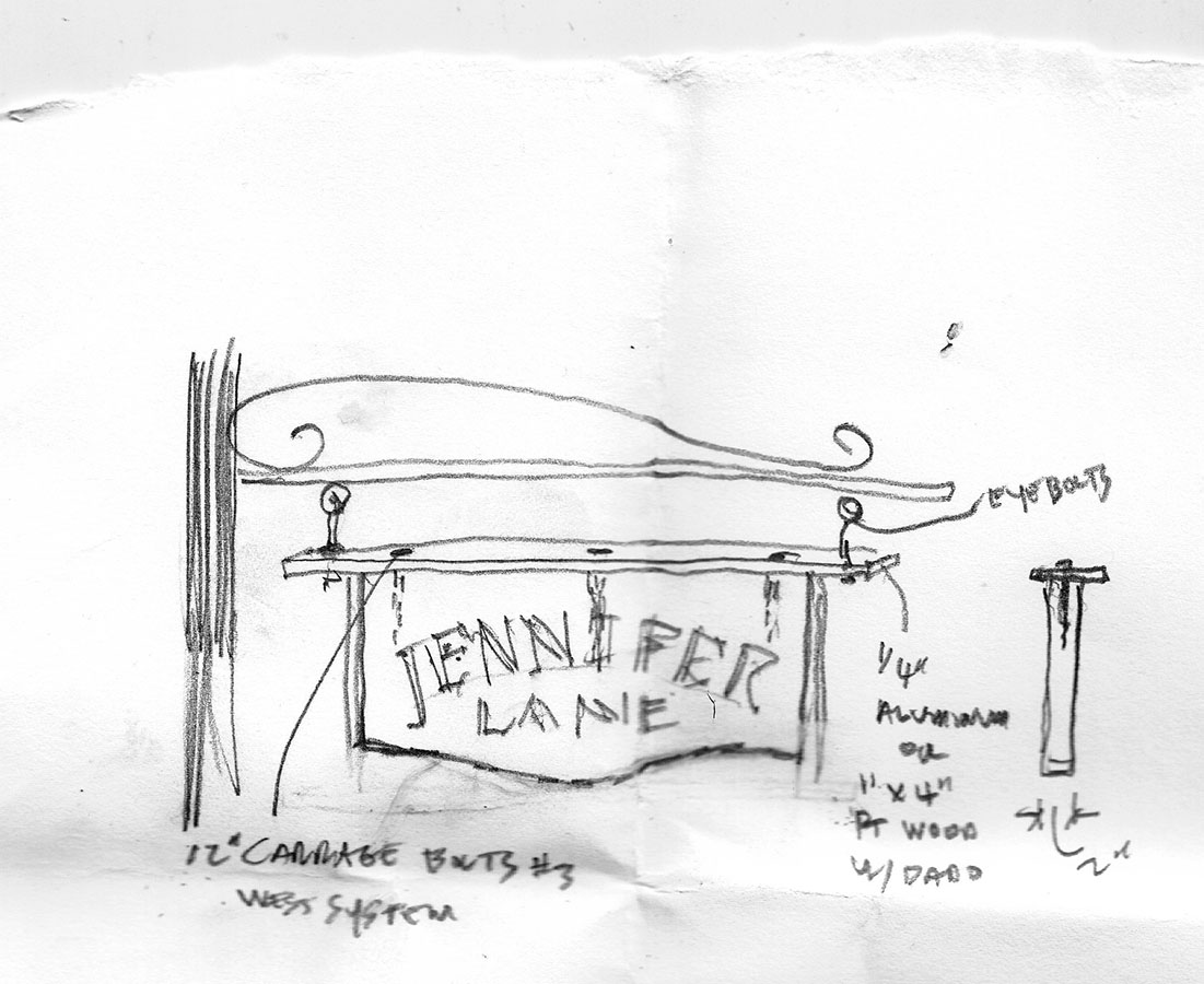

Rick, use to put model airplanes together as a kid. Your drawings remind of those. Did not want to spend that much time so just roughed it. neato.jpg
Anyway, I am jumping on the bandwagon on fabricating this sign. Simple as possible. Flat stock on top, either aluminum or pt wood where eyebolts are attached to that instead of foam. Carriage bolts through top plate into HDU with oversized holes filled with 2 part epoxy. (Six10 thickened epoxy adhesive West System) One piece 2" thick, keeping it as lightweight as possible.
HDU. Pole and scroll bracket by others. Dug in as Rick suggested.
