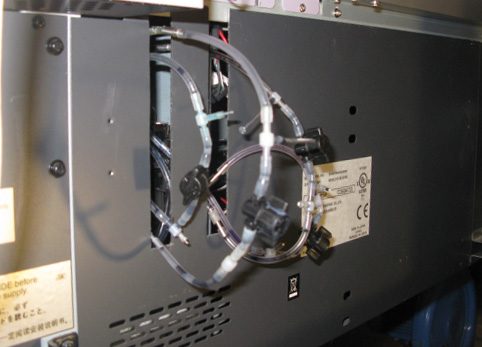

i added this replumb recently to the back of my printer. makes head soaks and other diagnostics very easy.

I seriously don't think he has time to do anything like that!!!...LOL
Good Mod though.
