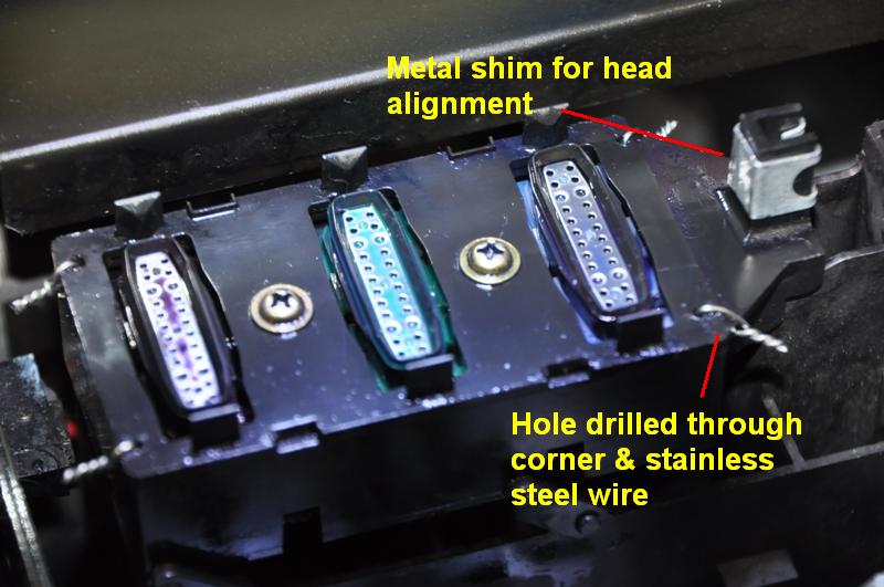

Thought I would share these little fixes with you, Our printer is 8 years old & over time quite a few flaws are rearing their ugly head. firstly the capping station top warps over time from the solvents so an easy & permanent fix is to carefully drill the corners & use stainless wire to clamp the top down, it may not look pretty but it works really well. the other fix is there is no adjustment for capping station alignment & we found our heads were not lining up dead centre, it was only slightly out & when I had a look at the mark left on the heads it was quite clear there was an issue with alignment, an easy fix was to place a shim over the stop on the right hand side & problem was solved. obviously this wont work if your capping station has to move in the opposite direction:doh: I haven't had to go there. Hope this helps & sorry if it is a repost but I could not find it with a search.

only three heads?
oh... I guess it's a 6 color, and mine is a dual cmyk set up, so I forgot 2 colors per head is possible
