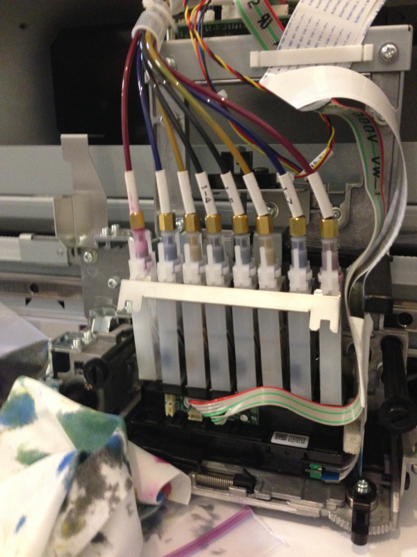

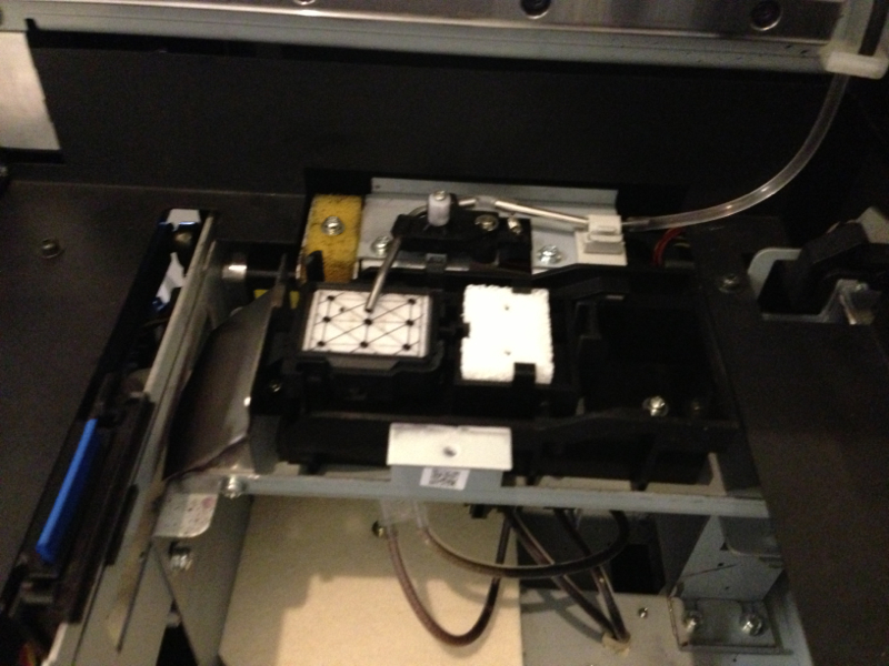

ironchef
My two magenta dampers are getting replaced as i type this. Im kinda enjoying this down time, they are also replacing the print head and capping station.
