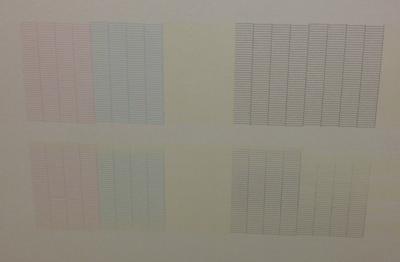

JV33 ink dripping?
FatCat
My guess would be your yellow O-rings did not seal properly and are leaking where they connect the dampers.
Freese
We need more information. MUCH MORE!!
Drops of ink when printing fine lines or even in idle.
Solid prints look fine.
Did a test draw after and it looks like the yellow migrated over colors indicating data cable.
Check pics.
