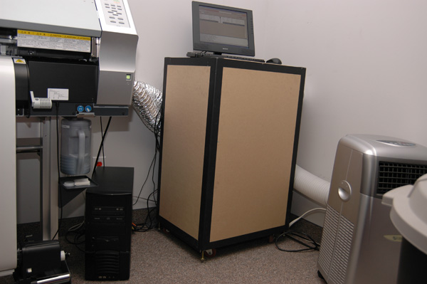

Here is a pic of the scrubber ...
We cut-down an old server cabinet .... inserted some 1/2 MDO. Bought a motor/fan from Grainger for 200 bucks and exhuasted it out the bottom ... just above the motor is an expanded metal/screen/blue filter foam partition. We put about 50lbs of charcoal on top of that.
We got a couple dryer vents from Home Depot and they fit perfectly into the holes in the back of the Mimaki. We placed a couple of computer fans into these vents as well to help pull the fumes. We use dryer vent hose to route the fumes into the scrubber through the side towards the top. The scrubber pulls the fumes down through the charcoal and exhausts the fresh air out of the bottom.
Next is a relay so we can attach it to the Mimaki outlet and let it control when it runs. We also need to wrap it ... just haven't come up with a cool design yet.
Works great and it's a nice stand for our rip computer.
