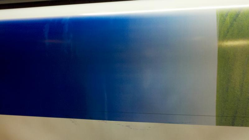

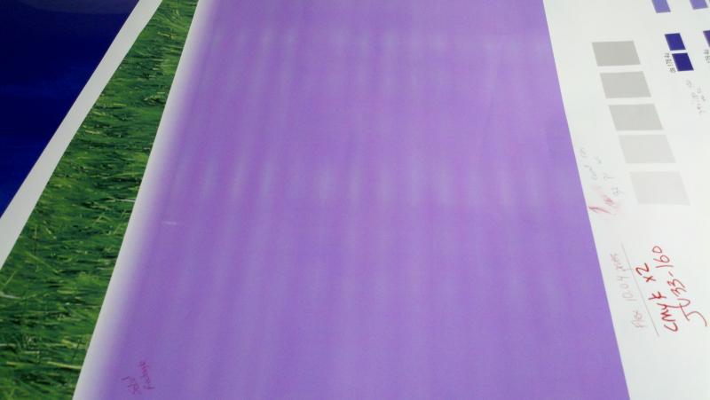

JV33 Odd Banding/Striping
Please look at the photos people..!!!
This is a brand new JV & the tech was here for 8 hrs and still no resolving of this issue.
I am printing on Avery supercast EZ RS but it also hapens on 3m 180c v3.
es3 inks Orcal 3651 720 x 720 profile 16 pass bi directional.
current heat settings are 95 95 122
Thanks:frustrated:

The banding in the purple especially looks like too much heat. But your heat settings look low to me. This could also be due to ink starvation, but I wouldn't expect that from a new printer operating at 720x720 16 pass. Have you tried other profiles?

Ditch the profile. Find a 540x1080 6-pass profile and try it both bidirectional and unidirectional. This is the optimal resolution for this print head, you will get better results. 720x720 profiles introduce a lot of banding.
Not sure what RIP you're on but a good canned profile is Avery's MPI2900 540x1080 6-pass, we've tried to write a better profile for cast wrap vinyl and as of yet have not been able to top this one. We're on Onyx so the same may not be true for this profile written for another RIP however.
Letterbox Mike
The JV33 is fairly susceptible to changes in media compensation, it's wise to check it periodically throughout a print run to make sure it's still good and adjust it on the fly if necessary. Drop pos. doesn't need to run as often, you're supposed to do it when the material thickness changes, but we keep ours dialed in for thin vinyl and only adjust it if we put in something really thick like wallpaper and the prints look blurry.
Neither of those has anything to do with your problem though. Unless you're having a major electrical/data problem with your head, I'll almost 100% guarantee you that switching to a good 540x1080 6-pass profile will solve your issue. The Epson DX5 head does not play nicely with 720x720 profiles most of the time, and a cast film like the wrap films you're printing are usually the worst at bringing the issue to light.

Did the tech that installed the printer prime the dampers when he installed it? It looks like a classic case of ink starvation. Does it do the same thing with other profiles?
I dont know a dam thing about creating profiles.
The tech bled all the air out of the dampers and filled them to the top.
The lilic print is pre bleeding dampers the blue sky print is after all that.
