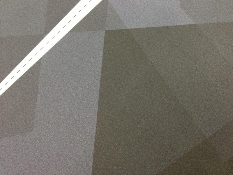

I have been struggling getting my JV33-160 to print solid colors. The art file is vector. Attached is a photo of the best results I can achieve...

Looks more like a media issue due to low color saturation rather than anything the printer is doing.
If you have other pictures that show more why you think its related to the printer, please add those.

That looks like a combination of media, resolution and heat. Your pre and print heaters are extremely low, which can cause unpredictable color. The resolution you have listed as 720x1080, I'm assuming that's a typo, I don't think that's an option on the JV33, but I could be wrong. Either way, try going to 540x1080 6 pass or maybe 12 pass, and bump the heat up a bit. I don't know what you're printing on, but you should be able to get 5-10 more degrees out of both of those heaters.
