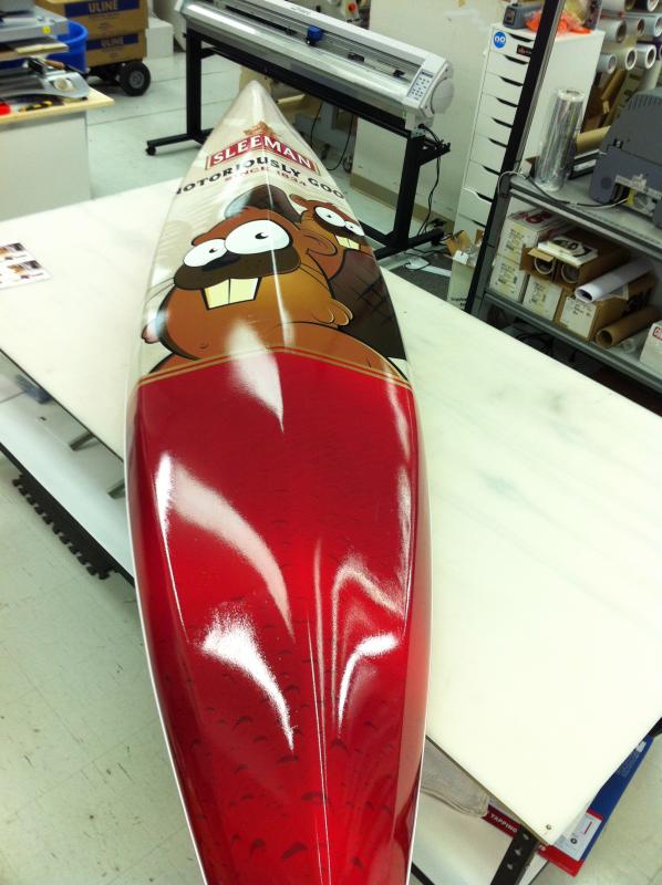

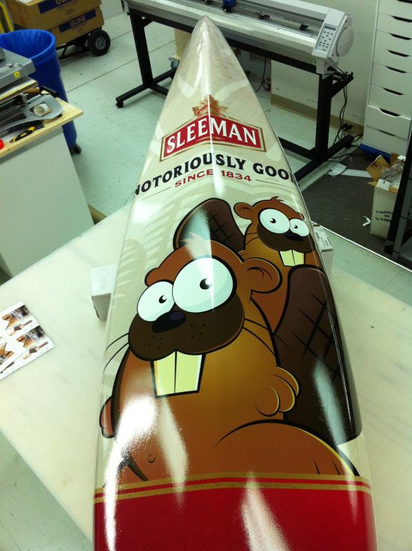

I finally got the Kayak wrap completed! Turned out very nice, and the customer is thrilled! Printed on IJ180Cv3 with 8519 lam. Printed on the HP L25500 Latex printer.

VERY nice job! How long did it take? Was it difficult?
Just shy of 4 hours... but then keep in mind that I'm NOT a wrapper! Lots of patience and even more patience! Obviously, the tricky part is the narrowing contour towards the front and back... again, trial/error and patience.
That's sweet! I have a longtime customer who is into kayaking big time. I'm going to show this to him. Who knows ... I might be owing you something for helping me getting a job off of him :thumb:
I'll only charge you the minimum commission Baz!! :ROFLMAO: Make sure to use lots of primer if you do one... the vinyl doesn't stick to the fiberglass very well. This one isn't critical, as it's a promo item. They're filling it with bottle caps and running a contest to guess how many "beavers" are in the kayak!
