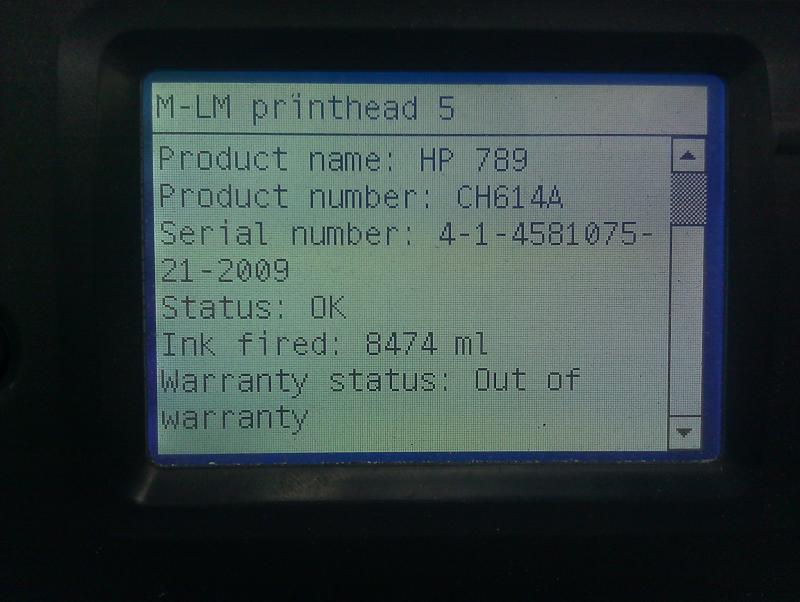

Now I'm afraid to swap my oldest head. :omg:
That one head has fired almost 2.5 gallons of ink. I have a couple over 5000ml.
