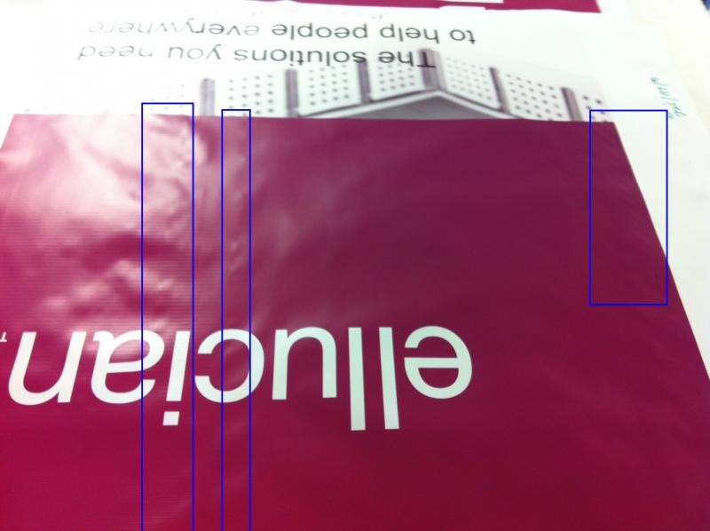

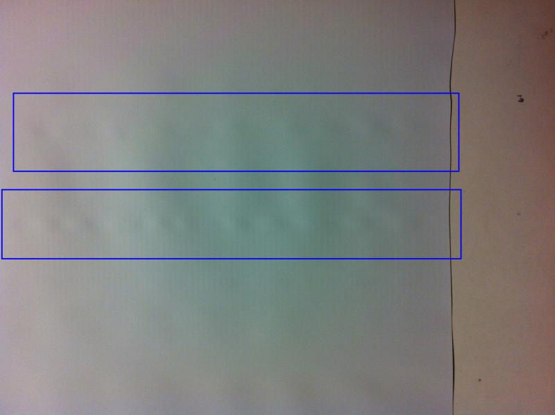

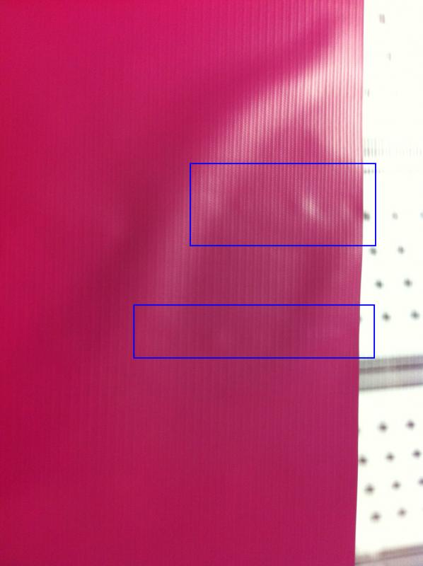

Has anyone else seen the issues in the photos here? This seems to happen mainly with banner materials, and happens on every banner material I've run. We've got 6 types of latex media in house and can only print on 2 of them with decent results (one is an adhesive vinyl and the other a coated fabric).
I've spoken with numerous technical reps, and even one from HP. Everyone said to tweak the temp settings of the profile in 5 degree increments, which I have done. Most recently, I was working with a 15oz Key blockout banner and lowered the cure temp to 140 (the minimum allowed). The ink didn't cure and I still saw this issue. It almost appears as though the media is being warped or damaged somehow. If it was visible on only one type of media I would just blame it on that, but this is a consistent patter across multiple medias, so I'm really at a loss.
Any help would be appreciated. I've highlighted specifically what I'm referring to in the images.

Have the same issue. The temperature and humidity of the day seemed to be the issue. Waited ran it in the middle of the night at a cooler temp and humidity and it worked fine. :banghead: Any low temp., low humidity night sign shops should run right out and get a L26500. :rock-n-roll:Ok I'm being a smart as* but it is frustrating when a machine does not work as presented!!! Ahm... To Whom It May Concern @ HP .... Banner materials of all kinds are not working during the day at room temps of 78 degrees F and humidity above 35%.
PS I changed all the profile settings too. Just like you.
Eric_Pearl
I'm glad to know it's not just me or this specific machine. Going to try to look into cooling the room and lowering the humidity a little (right now we're at ~47% and 80F). That would explain why we had less issues when we purchased the machine last November! It seems odd to me that the environment of the printer would have that much of an influence on the results, though. Kind of a bummer to find this out now.

same issue here. my only fix/workaround has been to lower the print temp to the lowest, and the cure temp to where you need it to be to completely dry the ink ....and then you need to pull on the media as it prints, or have enough already fed-through to tie to the take-up system so that it puts even tension on the media while printing.
....downside to this, however, is that your banner is ever-so-slightly warped. overprint with intention to trim-square.
