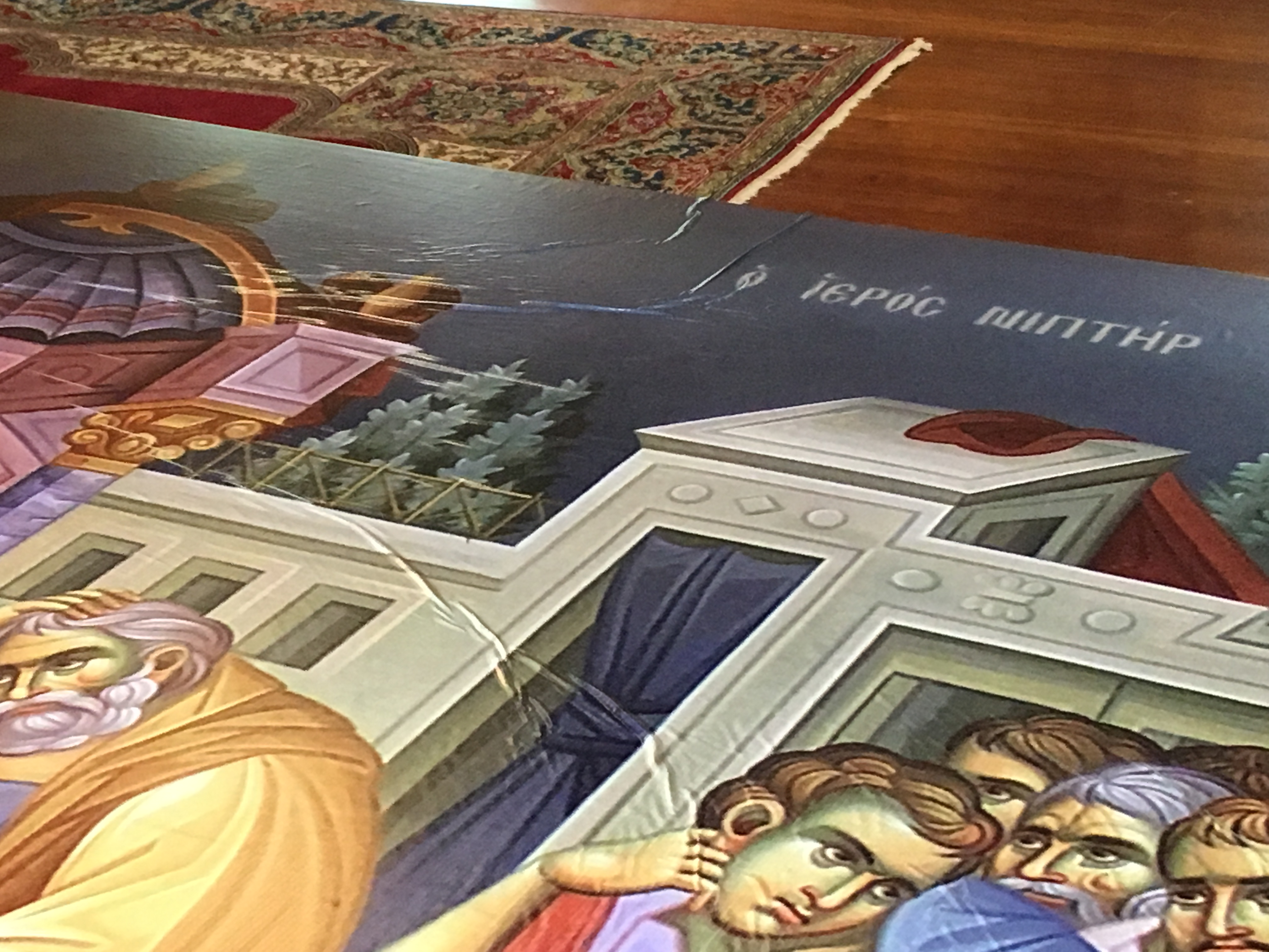

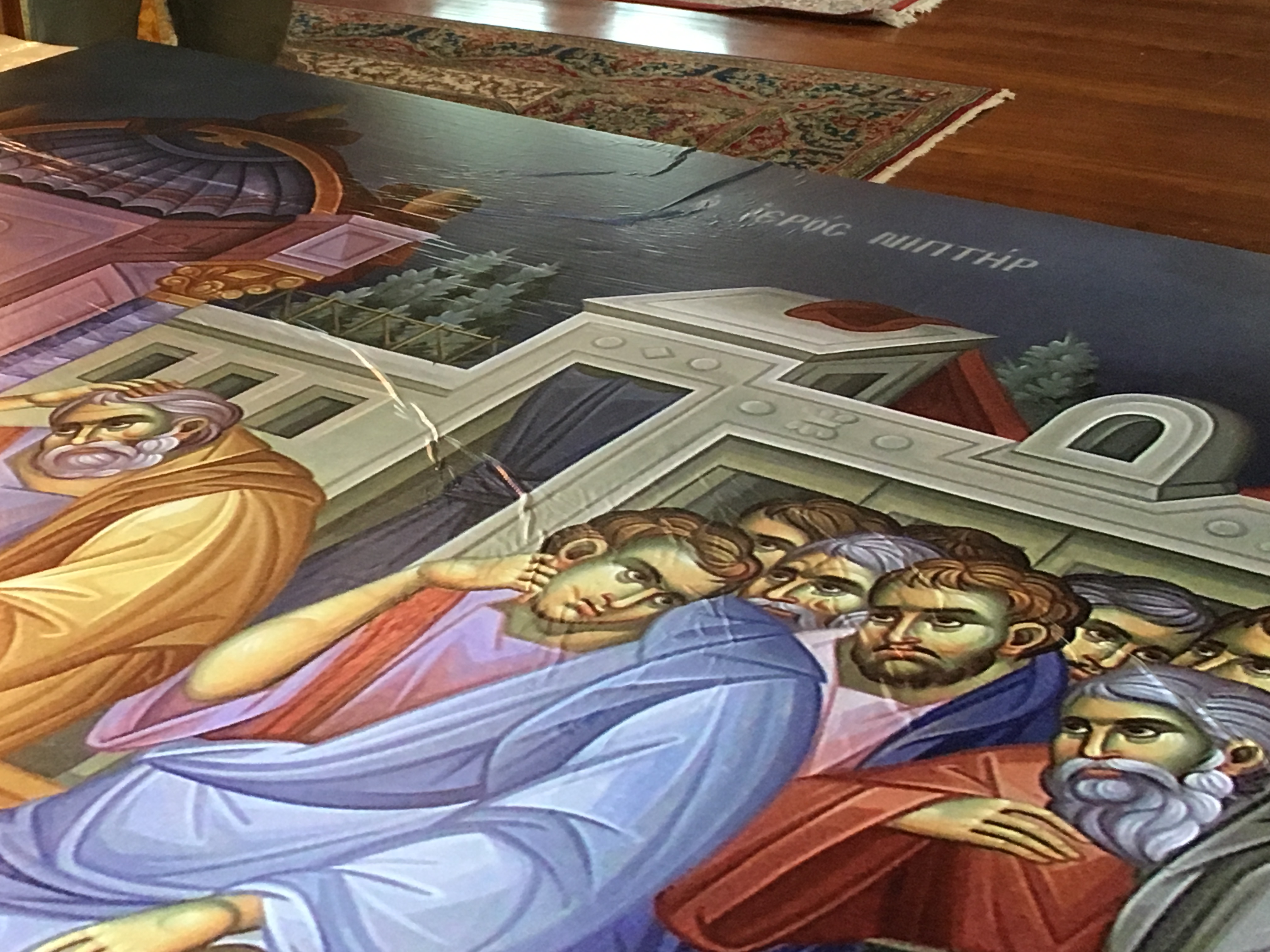

About 7' x 7', glued today, glue became contact like after drying too long and we got creasing on rolloff...tube on table
7EF9B63D-C097-4BA1-B85E-65B3898C9308.jpeg F5EC2E4A-659B-450A-9F89-96D58B36107B.jpeg
This creasing below is nothing bad and we can work out.

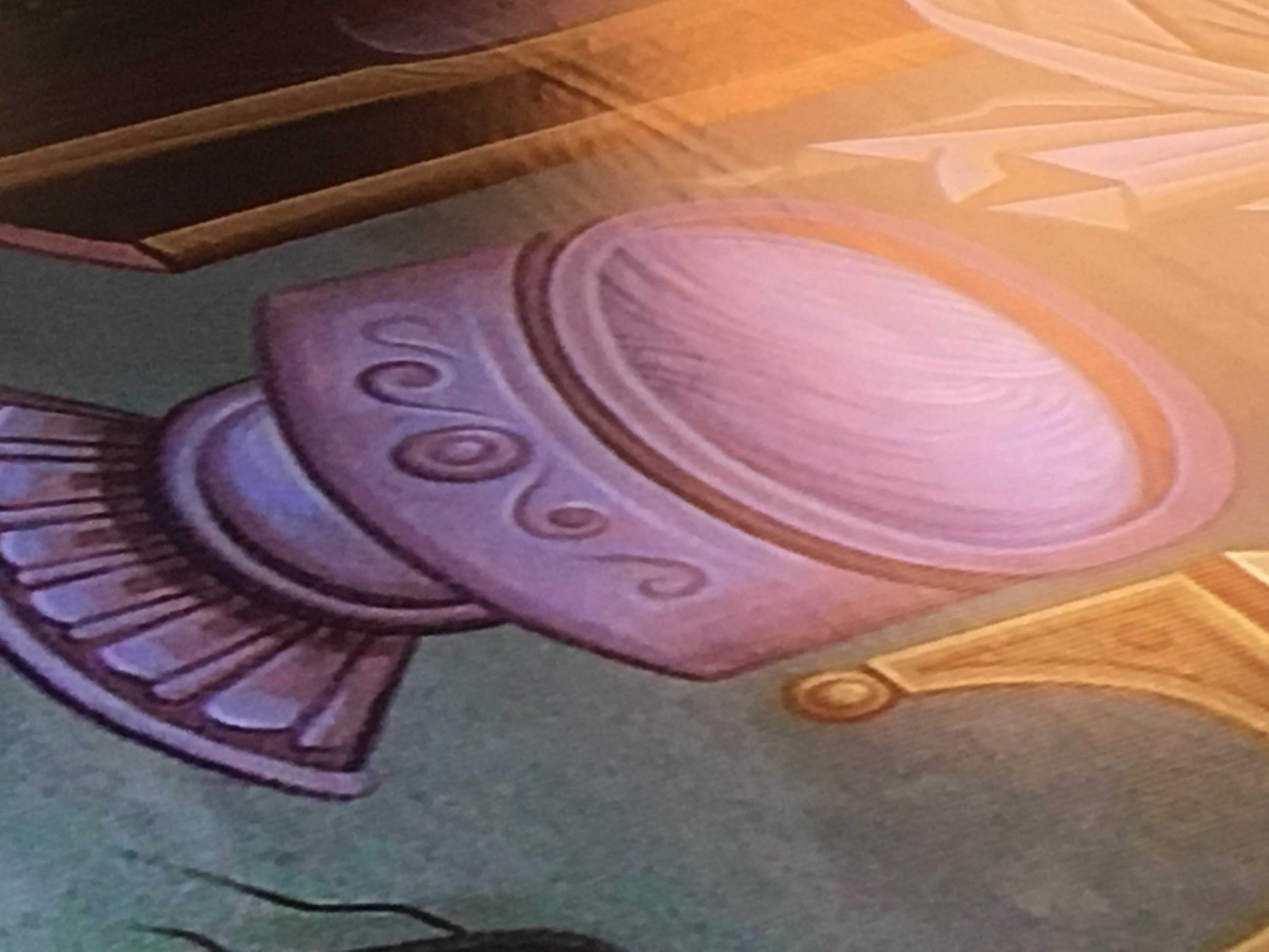

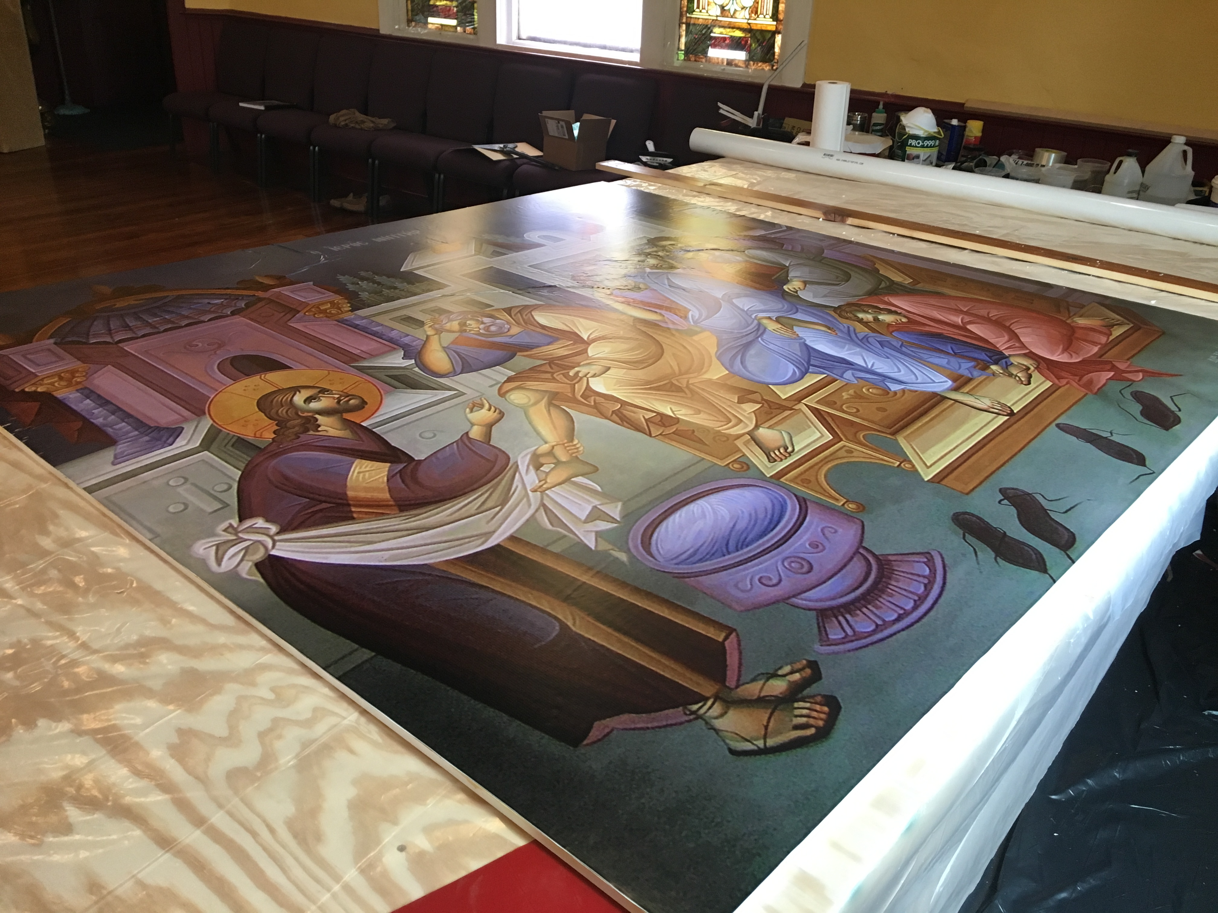

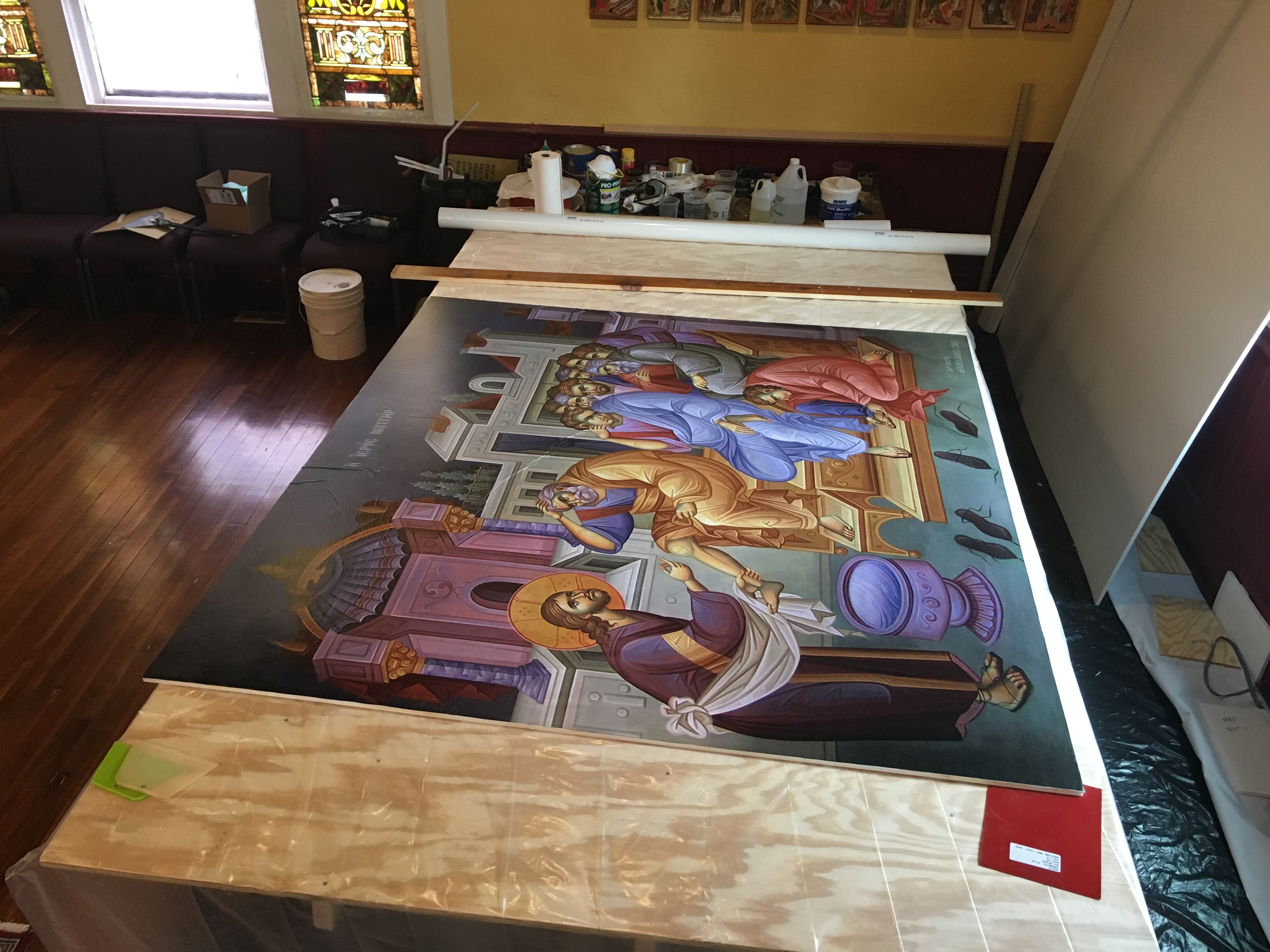

Thank you for replies. We rolled a mural/icon today. We discovered that contact adhesives are less than ideal. The first two we did; we used varying thicknesses of glue and we allowed an induction time today of 20 minutes and the glue became like contact cement and did not work well for us. We will apply next time no induction time and let the glue dry overtime. Here are the requested pictures and you'll see some of our application troubles on close look.

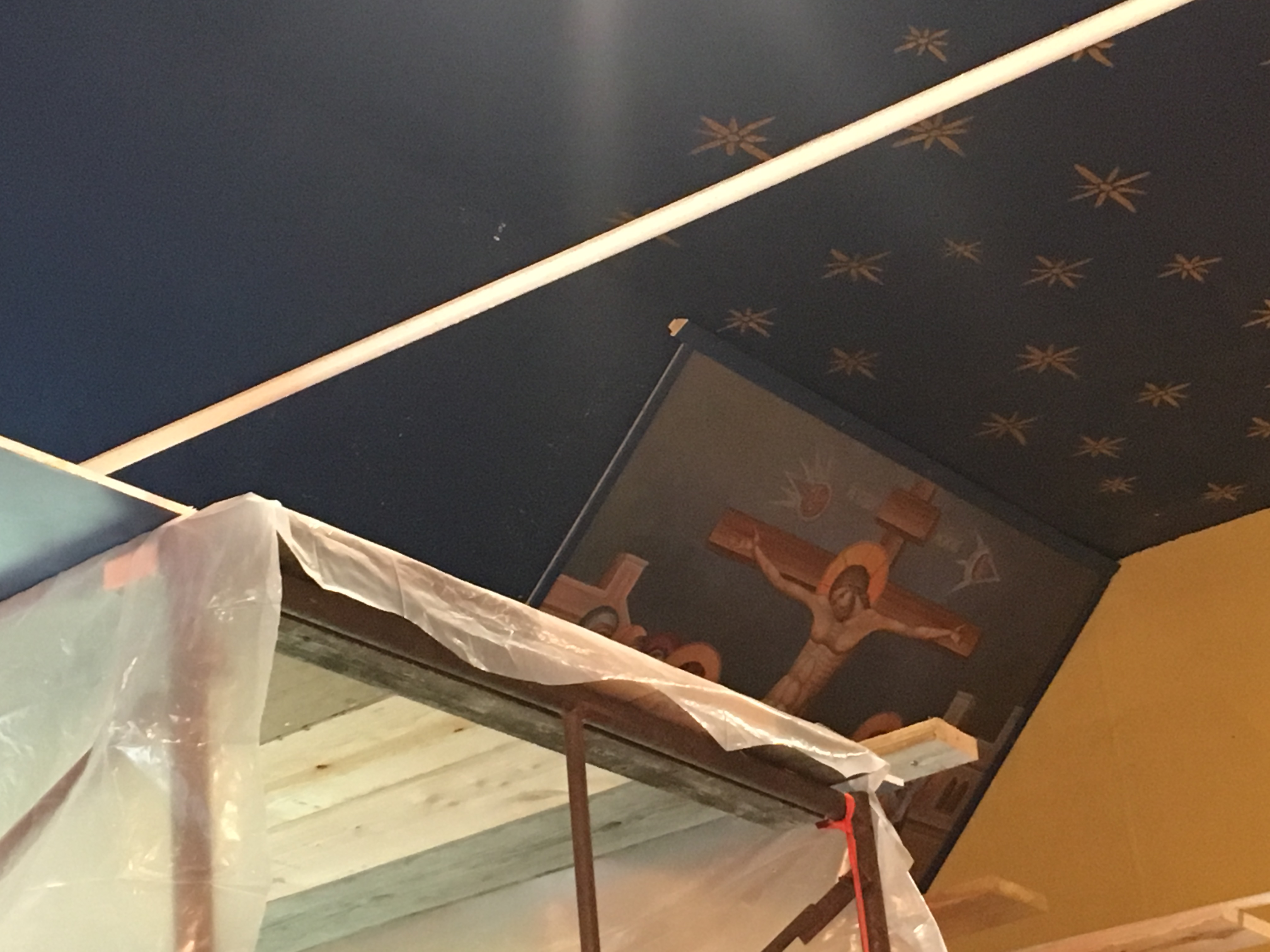

This is a 7'x7' icon already on the wall. It rolled out better than the 3rd one. A second mural rolled best and will be applied to the building ceiling tomorrow.

Contact glues offer no forgiveness on rolling off the tube as we discovered flooring adhesive behaves as contact glue if allowed to dry a bit too long and we ended up with wrinkles.

Would we be able to make corrections and lift the mural up if it is wrinkling or creasing? It seems like a minor delta in rolloff tension results in creasing. The floor adhesive allowed us some ability to pull errors out on our first part. The third one dried too much and became like contact glue and we had no chance to lift off and fix wrinkling.
