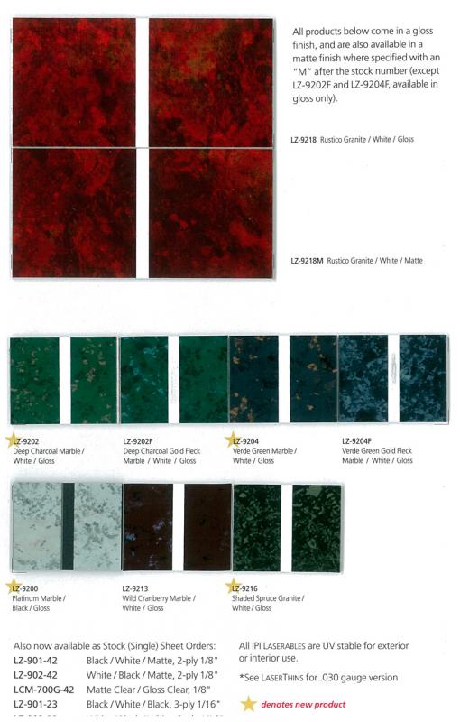

Whoever you're using for the lasering should know about rowmark or IPI range of similar materials, which are layered plastics.
To date, I am yet to have a request for one of these, but please refer to attached for a sample of what's available in a laserable material which might suit?

Custom Grafx, thanks for the Rowmark samples. I spent a few years running engravers through all that stuff, but I wasn't familiar with that Verde green/gold fleck stuff. I don't think it would be as good for this job, even if it is a translucent backlit stock (which it appears not to be) because there are other areas i have to paint this faux patina, so my method at least will be very similar throughout the project, albeit much more labor intensive.

They do come in a version which is reverse engravable (I have used their reverse white/matt clear - it's a great product with paint fill). I imagine it should be quite hard wearing, and the engraving being on the sub surface would prevent any scratch or flaking problems you may face with the paint version.

I've done miles of reverse engraved plaques, but didn't see the matte clear option for those textured samples, which would then need a white diffuser... but I'm pretty stoked with my custom solution anyway...

They look textured but are not... a printed pattern of some sort I guess... anyways... your painted version, definitely better as it's closer to the real thing.
