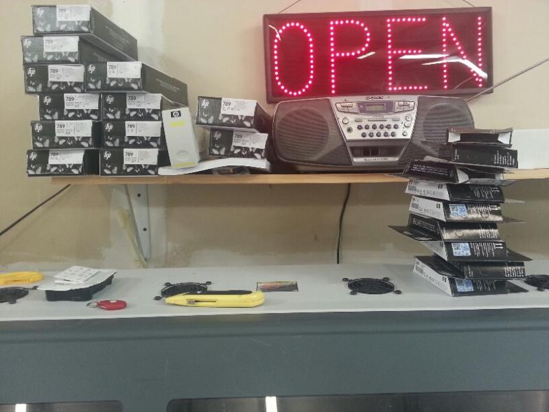

we have 3 of each head in stock. We print 8-10 hrs a day on both machines, and are changing them out quite a bit.
