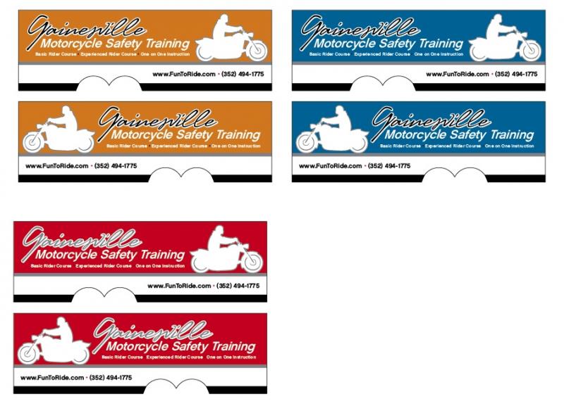

I am doing a cut vinyl job for a friend's business. I am not a graphic artist by any means, nor do I have any formal design education.
I would like some feedback, if you would be so kind, so that I may improve my skills and expand my knowledge.
Feel free to be mean and call me dirty names.
The design was done in Adobe Illustrator CC 2014 with the intent of using Oracal 751.
Thanx everyone.

Thanks for the feedback.
What color combinations would you suggest?
And what do you think about the red secondary text? I am not so sure about it. It's bright and easy to see. But, I worry it may be too bright and blur out when people try to read it from afar.
J Hill Designs
ditch the red dropshade, change the laundry list to black, keep the top copy away from the top a bit
side to side negative space isn't bad, but its crowded on the top

Well I am not gonna slam ya since it is readable, more than I can say for my next door neighbors long trailers that park in front of my place, that a long time sign company did for trade, (just happen to know this) & very few of there signs look or are read well.
Think about what you are trying to say, the most important message & clients customers ...Motorcycle Safety
Group into 3s your main copy in this case (the who & what), group the 4 words into 3 sizes to look at, or if you will 3 different weights of copy.
The next group is (where) phone number & or website
Next is information in this case the blah blah blah (meaningless babble) yes the tag line is good but the name is very long so it becomes babble.
You kinda did this already, so some tweaking is in order.
Now if you truly want to learn how to layout advertisements Mike Stevens wrote a book Mastering Layouts, kinda a sign bibile for this.
As for red & black together rarely does it work well.
As for using red keep it to a minimum like the main focus only or where it adds color without taking away from a stronger message making both confusing to look at.
Hope this helps, PS there some good sign shops in your area that charge good money, so I hope you get serious & you will be a welcomed addition.

You guys have been extremely helpful. I'm going to give it another crack on the layout with everyone's advice and come back with what I hope to be an improvement.
Now, what about drop shadows? Without reading the book suggested, what are some good color combos?
