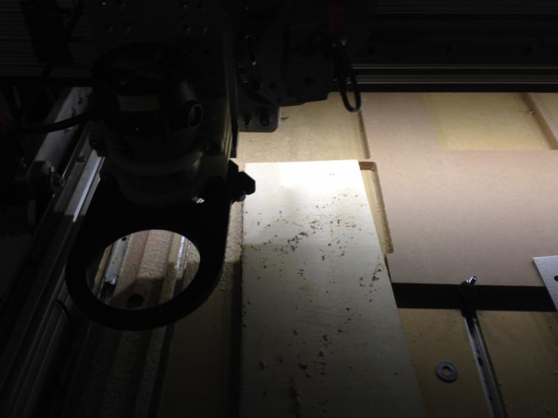

I installed LED's on the bottom side of the x axis on my CNC. Light is on the work and it is great.
Used 4 ft of three LED light modules and a 12 volt wall wart. Cost about $6 bux.
Now the table is well lit no matter how dim it is in the shop.
