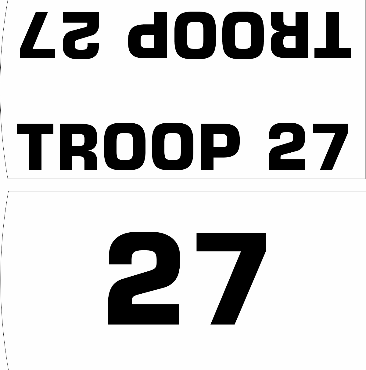

Our local Boy Scouts have a trailer I'll be lettering next week. They would like a number on top in case of theft, so it can be seen from an airplane. (lots of different people will be using it and with that, it's likely it doesn't get properly locked at some point) Apparently this is a thing so I'm hoping someone knows what size I should make them? He just told me they need to be seen from an airplane...I'm not real up to date with airplane heights. Thank you!
Many of the local police departments do this to their cruisers, trucks and equipment trailers. The numbers we made were usually about 18" tall and not at all condensed. For them, it was helicopters, from a few hundred feet, but an airplane, might be larger from a higher altitude.
unclebun
Here's an example of two different ways to do this on a typical 6x12 trailer roof. The one with "TROOP 27" has 19" letters. That gives a 190' easy readability and 400' readable.
The one with just "27" has 37" letters, yielding a 379' easy readability and almost 800' readable distance. The smaller letters can obviously be cut from 24" vinyl, while the bigger ones can be cut one letter at a time from 30" vinyl.

Airplanes are 500' minimum altitude. When I was lettering police cruisers they wanted the "helicopter numbers" on the roof as big as humanly possible.

Very informative friends, thank you very much! This will allow me to present a couple options
