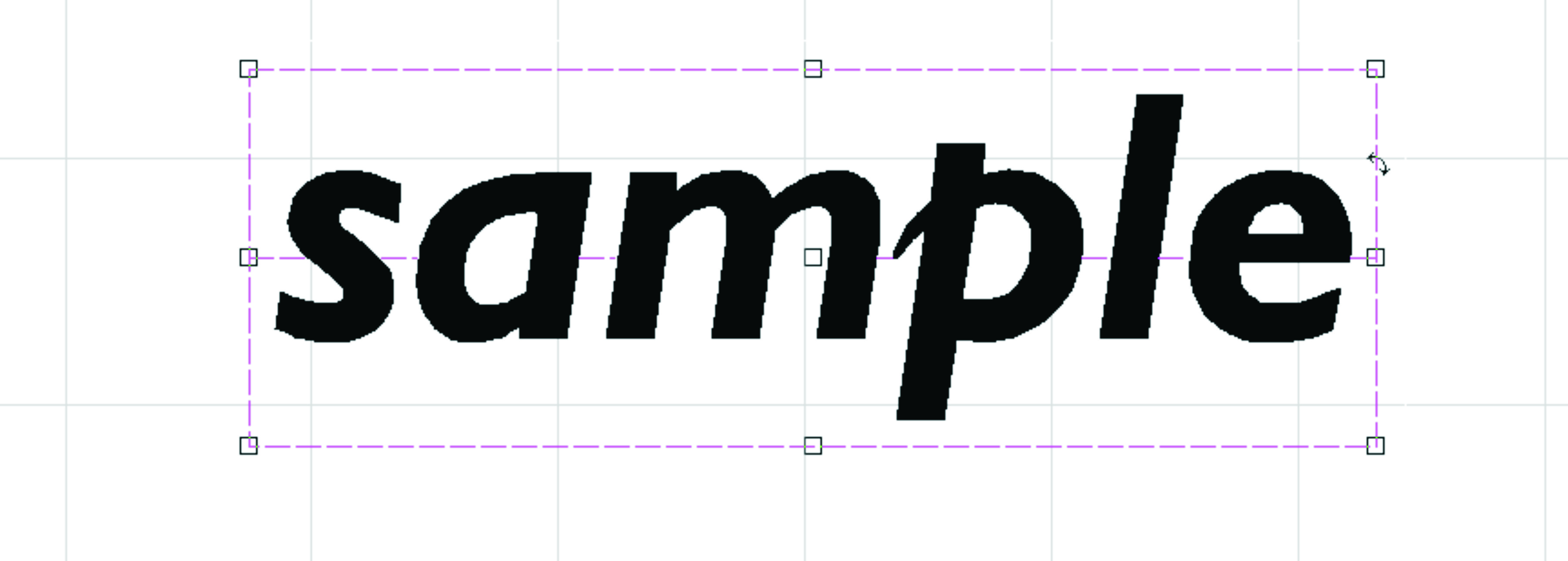

Put a weed border around lines of text with a cut being horizontal at halfway thru the letters. Then weed top half, bottom half. Helps with smaller text. I normally rip weed small stuff off of my graphtec. My wife simply can't do it from fear, lol. It is either cut right or it isn't.
