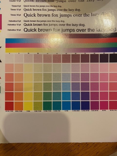

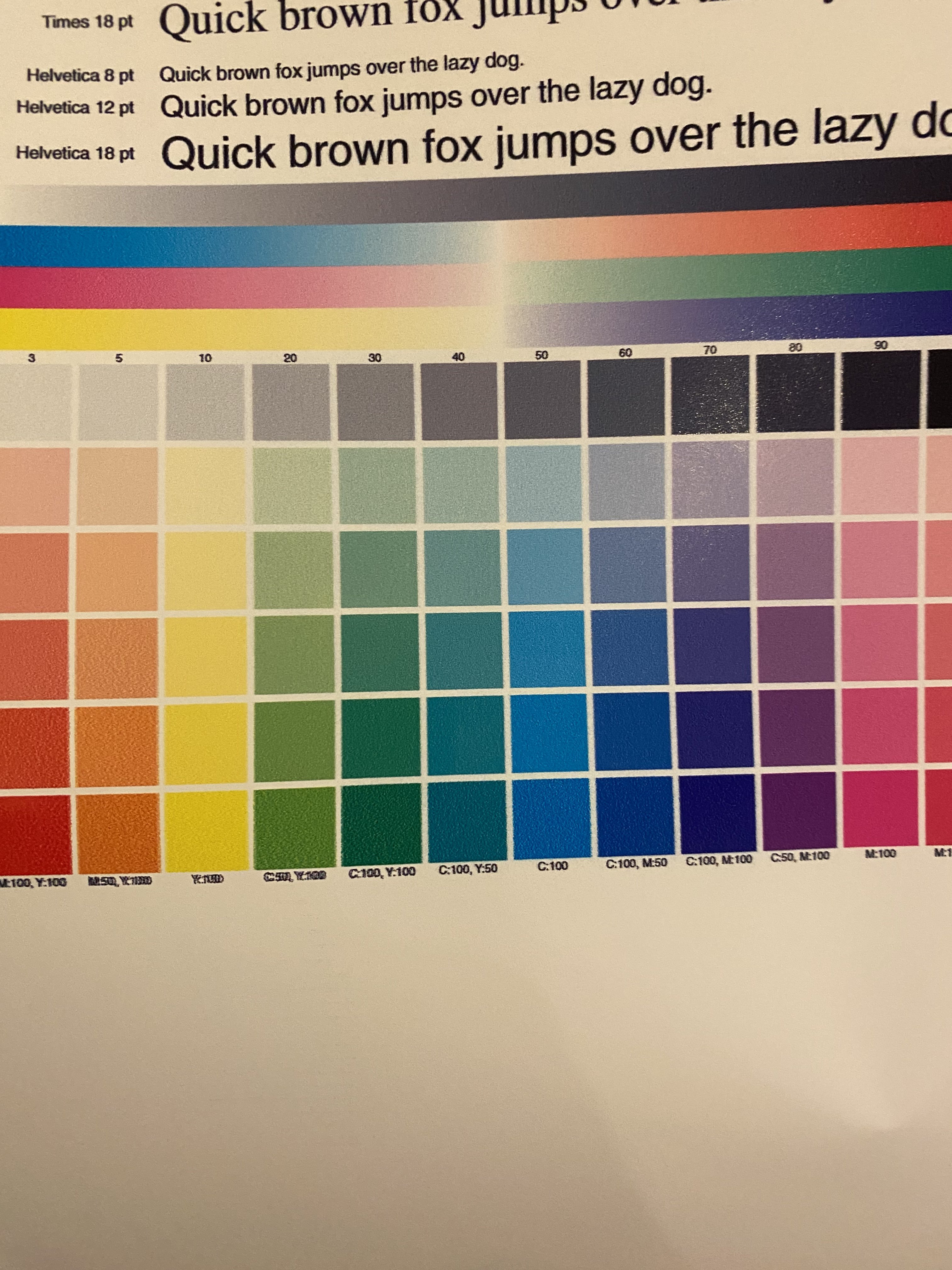

Hi, Ive only been using my VS540 for a week and my colours are starting to lack quality. The 2 test prints below have exactly the same settings in versaworks and illustrator but you can clearly see stripes in the green tones.
What could be causing this?

Looks like you're probably missing nozzles in your nozzle check. Did the person you bought it from train you on the maintenance of the machine at all? There's a few basic things you need to do to prevent the nozzles from clogging. It's possible it needs a new cap top as well.

Yeah basically anytime you see lines like that it's going to be missing nozzles or a print feed issue.

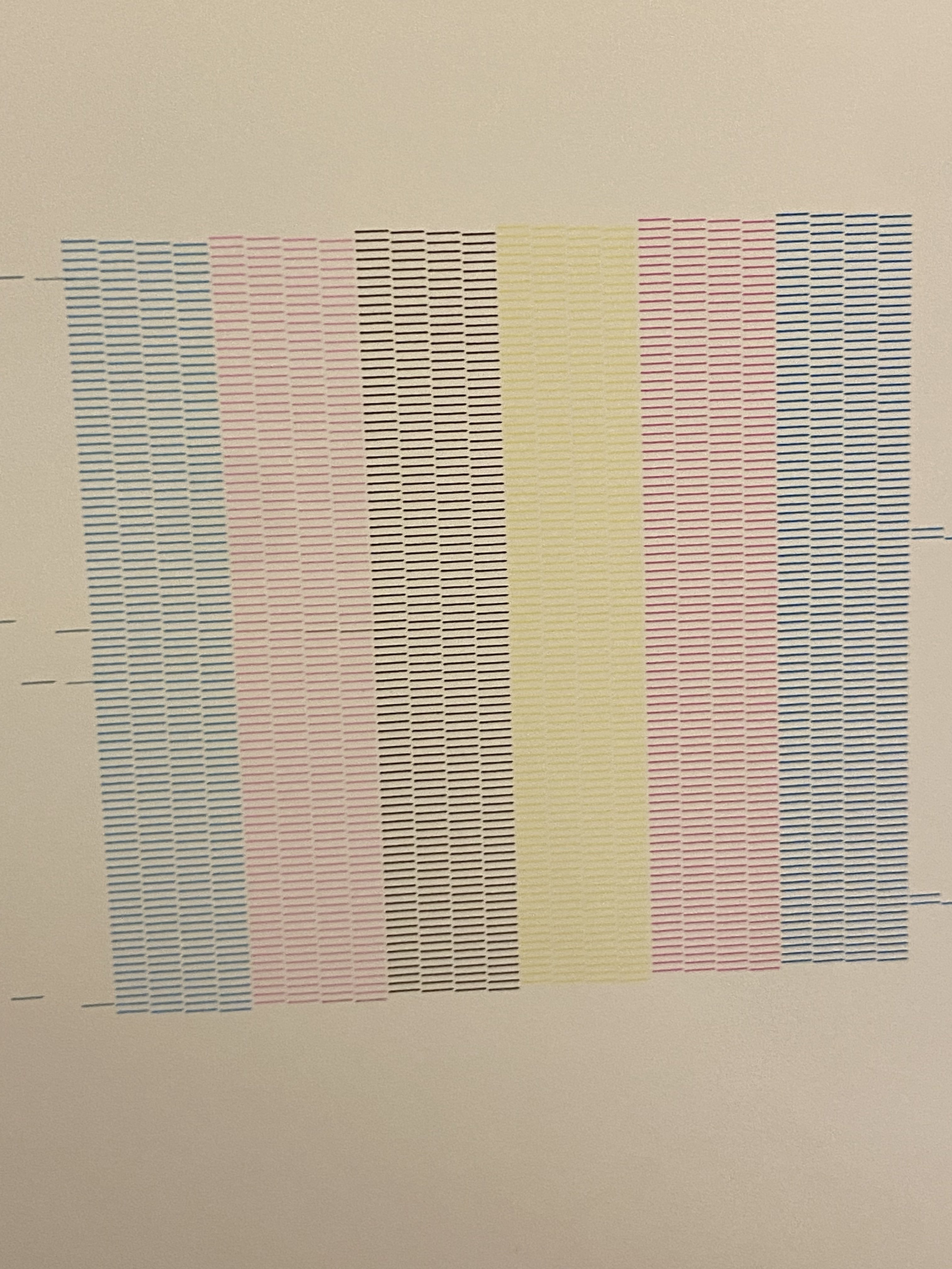

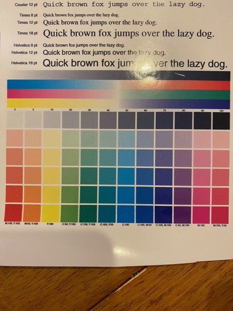

I think so, do they look ok to you?
Depending how often you use the machines, I typically recommend doing a regular clean once a day and manual cleaning weekly if using frequently, if not used often, a medium cleaning at least once a week and manual cleaning bi-weekly. Looks like there is still some graininess in the prints, might want to play around with print speeds, heating and maybe bi-directional vs. uni-directional. If still no better, you can try different profiles.
Thanks for your advice. When i print other things rasta and vector and select high quality it prints very solid, it think its just the test print that prints standard quality and so its grainy. Been playing around with quality settings and getting really good results, especially yellow brightness as it was abit dull before. Ill follow your cleaning suggested time scales, thanks..
