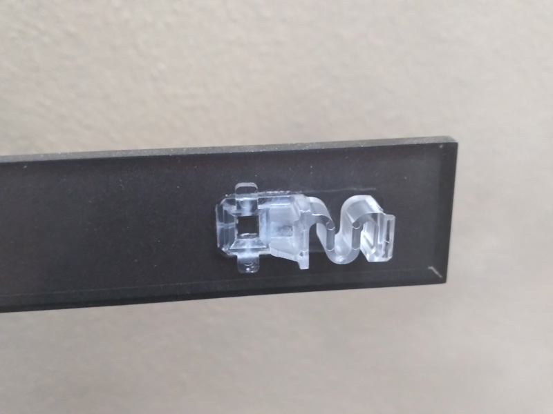

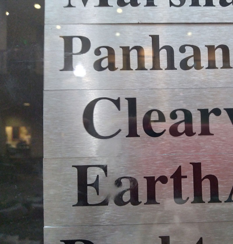

Looking for blank inserts for a couple of directory signs. Insert 1 is a thin flexible strip attached with 2-sided tape, brushed silver face 30x1.625". Insert 2 is a sturdier piece with beveled edges 18x1", brushed silver face with clips on the back to snap into the sign. I'm going to letter them with cut vinyl.
Where can I order a small quantity of blanks like this and have them cut to size? Former tenants moved out and decided to keep their plaques so there's a number of blank slots now.

You can buy a sheet of 3mm ACM with brushed aluminum back and white face. Cut strips with table saw or by hand using razor blade. The one with the clips, looks like brushed aluminum is attached to a acrylic piece and check bottom and sides to see manufacture label to purchase clips, or make an adaption of it to work.

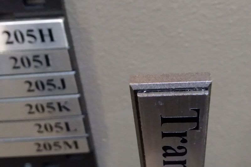

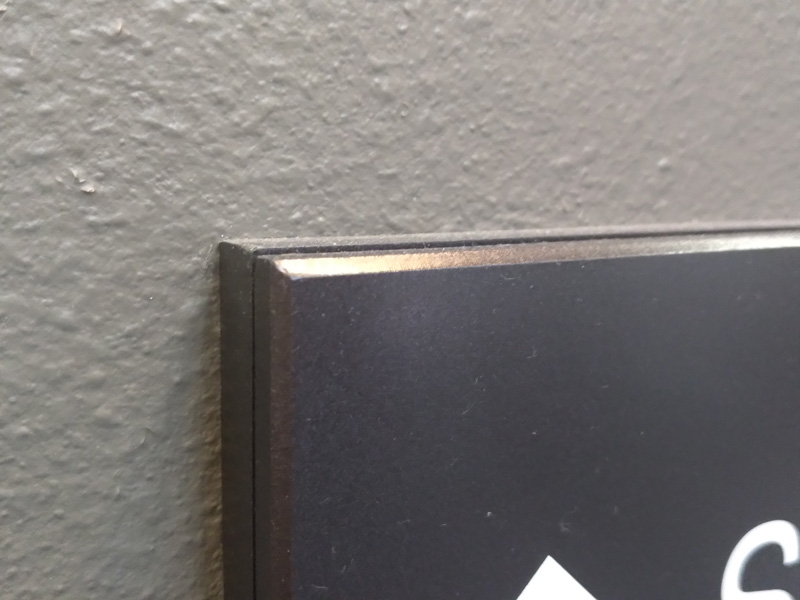

The existing lettering is cut vinyl. I don't think the inserts with the clips are acrylic, here's a closeup shot of an edge. No way can I do a beveled edge like that and have it match what's up there now.
3mm ACM would be much too thick to blend in with the existing plaques on the larger board. The strips up there now are really thin and flexible, like 1/16" thick at most.

Looks like you could do either aluminum cut pieces from Gemini, or laser cut brushed aluminum plastic laminate for your substrate (Johnson Plastics). I wouldn’t sweat matching things exactly. Do the best you can and let the customer know it will not be a perfect match.

get some 1/4" pvc and place brushed aluminum on top with vinyl lettering. I am of course guessing on the 1/4" thickness

This is what I'm working on now. I found sources for the brushed silver top layer - comes in large sheets with adhesive back and I can cut down to size. The challenge with the acrylic part is that they're beveled and have cut outs on the back where plastic clips go to snap into the sign. Can't find them anywhere, maybe originally came as an off the shelf kit?

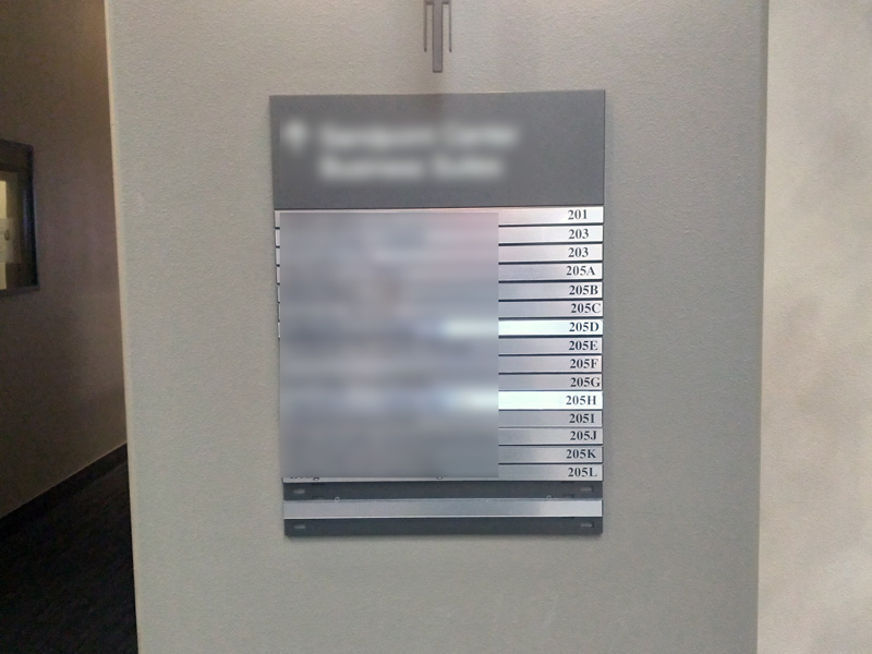

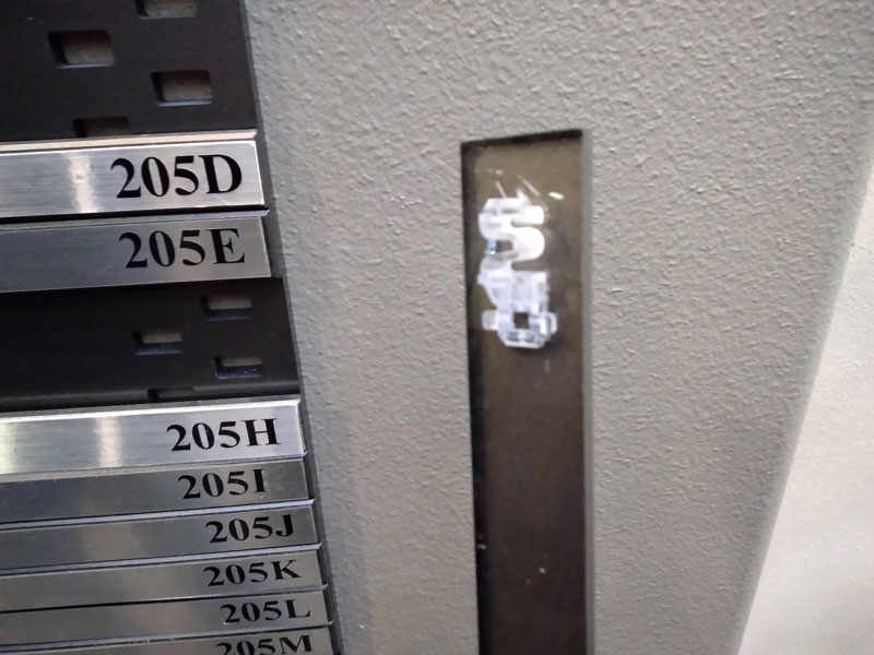

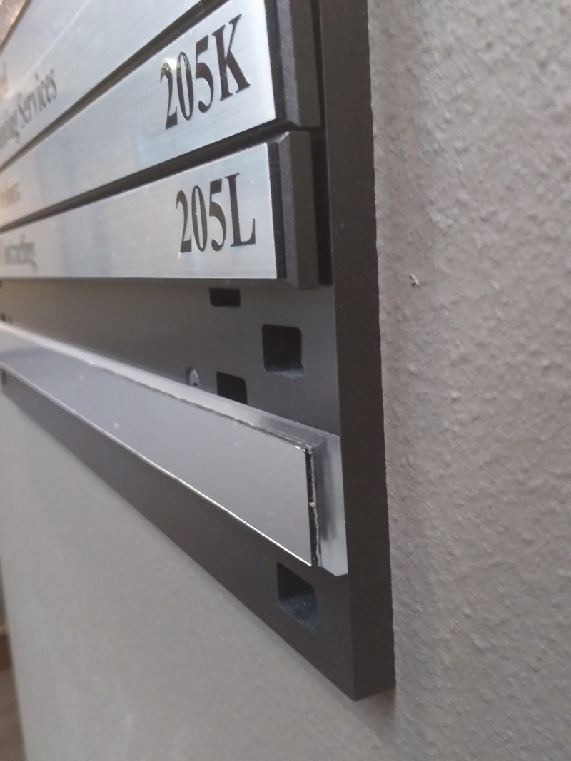

This directory is back in my life again. Customer is requesting a new directory on a different floor of the building, similar to the existing one. A few images are posted below.
Dimensions of the new directory will need to be around 24" wide x 32" tall. Tamper proof name plaques, cut vinyl lettering.
The existing directory looks bad...too many hands have been on it over the years, plaques have been stolen and reproduced with various materials (which is what I was tasked to do when it fell into my hands), lettering doesn't line up. I'm going to try to sell them two new directories so they both match, and easier to update if plaques go missing. The plaques on the current directory snap into the backer with plastic clips (as described upthread). I ended up using 2-sided tape to mount the new plaques.
Any recommendations on a wholesale vendor who supplies displays like this? Looking for some ideas and whether I should outsource it or put something together myself.

Ugh. I despise directory updates!! You're right about lots of hands being on them over the years. Probably because most shops hate this type of work.......and I'm one of them.
If you can sell them a whole new one....... https://www.clarkesystems.com/modular-slatz-vinyl/
