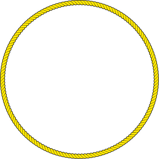

Having trouble and wondering if someone has an idea. Working on an existing logo that is a circle (image below) I tried to vectorize the below image to cut it out but it will not work in Flexi.. Went to Bitmap and then vectorize then bezier and nothing seems to happen. Working fine with other graphics but not this specific one.
Any ideas?

Draw one segment by tracing it. Make a second copy and do a blend(count how many segments you need). Then use fit to path to fit the blend to your circle. (This is for Corel.) If you do it this way you can get that clipart monkey off your back.

Wow, can't get any simpler to vectorize. About 2 minutes to do. Do one and duplicate it.

Illustrator.... draw one rope shape. Count number of shapes in border. Divide that number into 360. Rotate around a circle that number of degrees and duplicate. Probably 2-3 minutes
That is how I did this example

All you need is one good segment. In corel you can move your center of rotation away any distance, then use the transformation tool to rotate any set number of degrees then apply to duplicate.
