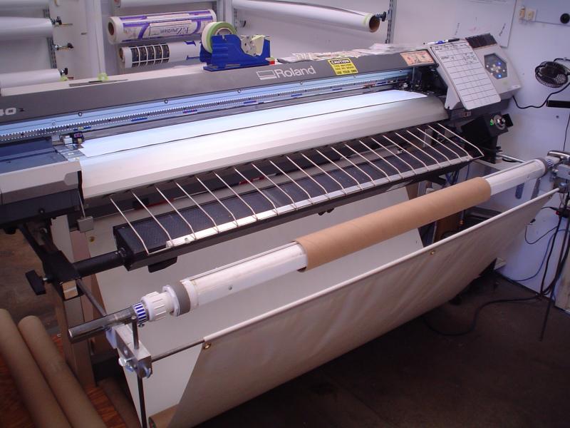

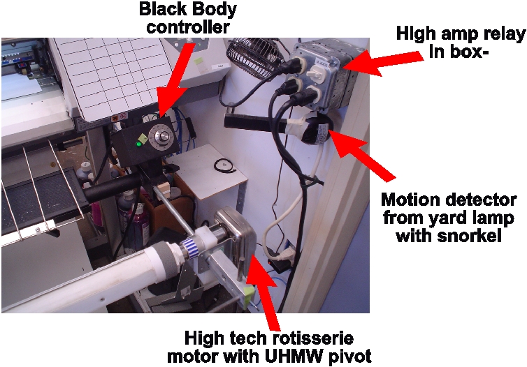

Gene@mpls
My solution is in the tips and tricks forum- premium. Here is a teaser
picture. Join and if in a year you do not agree you have saved at least
the $50... I will paypal you with it. Gene
