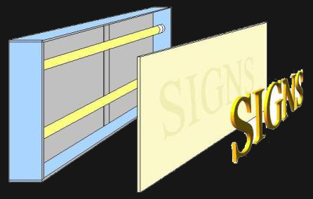

I've looked everywhere for a guide on how to make a sign box but all I find are tutorials on how to make a sign box for your bedroom which is something i am definitely not interested in. I am willing to pay you to come to your shop and learn the basics of how to make an install a lightbox sign or pay you to make a really really descriptive tutorial video, where to buy the parts/ wiring/ etc... I think its time to expand my services again and i think this is the best way. any help is appreciated thank you.
by the way the light box signs I'm talking about are like the one in the picture, not the ones that have the led strip along the inside of them.

signcomp kits would be the easiest way
but it aint easy
and it aint cheap
cheaper to order from wholesale
being in Tracy, try calsignwholesale - great people great product - they are in Modesto
player
Sign Comp, Sign Pro, Sign Tech all have manuals or blueprints.
It's pretty easy. Get a sliding compound miter saw. Cut extrusions to 45 degrees. Fasten corners together with corner brackets. Repeat with frame extrusion.
Add support gussets and raceways for electrical.
Wire. Cut face.
but it aint easy
and it aint cheap
i know exactly where they are at. thank you.
0igo
Wire. Cut face.
never knew they had manuals im going there tomorrow see what i can pick up thank you.

Or order a knock down kit that come already cut. Then put in the corner keys, and screw together with the supplied hardware....
But wait, it's not all that hard, but you really need to watch wiring the ballast. You'd be surprised how many people don't understand the typical ballast sizes, let alone know how to read the wiring schematics. And not to mention the importance of weep holes, and even where and how to mount the ballast...

exactly my point re: it ain't easy
order it, mark it up, sit back and wait for a painted, UL approved, ready to install, sign

If you have no experience fabricating illuminated signage.
Do what others have suggested.Buy a knockdown kit from a signcomp dealer.
It's a good place to start.
If you want to build your own from scratch you need a metal shop and learn the skills to make it happen.
Whether it has to have a label on it that's another story.
You can be a Ul shop
Just be ready to pay between 5 & 7 large a year
hope this helps
