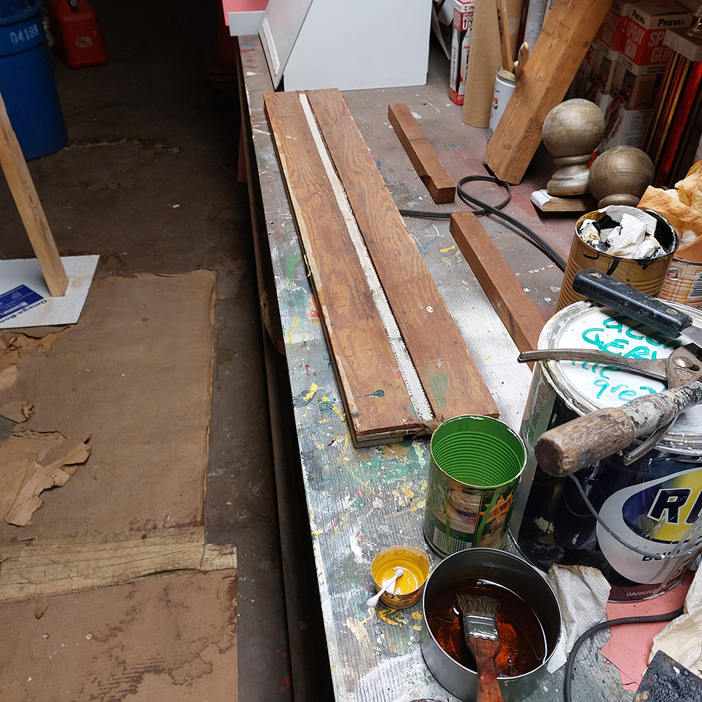

ebay has a few sellers of apparently the same machine, we have one of each of these and they do the job.
watercooled, and spare heaters are in the package.
Yeah, we have jigs set up for bending to our most common shapes.
That's only one workbench of many and they're all full of paint, glue and crap.

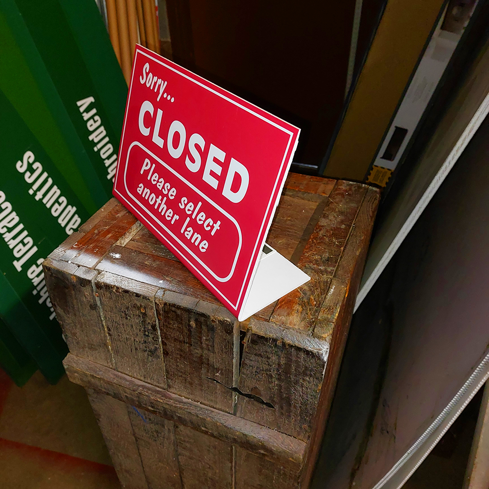

Have a 4' one my brother purchased 20 some odd years ago from local plastics house when I sent him to pick up an order. Farco Plastics is who we got it from. Local vendor to us. Think I paid about 3-400 for it. I remember mumbling to myself when I saw it not to let him go to vendors locations any more, lol. Easy enough to build but the one I have works as good as the day we got it.
Just used it about a week ago. Had 18 signs for a grocery store that said..... Sorry, this lane closed and hadda stand up at the beginning of the conveyor belts.
3mil pvc flatbed printed, cut and then bent. Ya hafta be careful not to burn the ink around the edges while heating it up. There's no dial or monitor for this old stuff. Ya just need to now when it's cooked enough. Took about 15 minutes to bend 18 of them and another 20 minutes or 1/2 hour to stiffen up so they'll hold on their own. These little ones we stagger timewise and while one is being bent another one gets started. I used to use another jig to let them cool down, but we have the slanted desk so we just set them on precariously and they form up real well.
