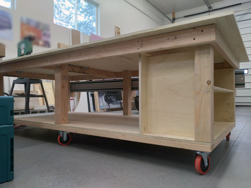

Any construction plans for this table?
We really need to build one. This looks like exactly what we need!
No plans, I hired a woodworker and he did a great job.
I was inspired by coming across this example for a 4x8 table, which goes into detail with a material list and instructions.
Update on my table: the little ledge on the side of my table to hold my saw tracks wasn't the best idea. I keep bumping the corners of the track and once knocked it to the ground. No bueno. I'm going to amend it somehow, or maybe cut my 108" track down a bit.

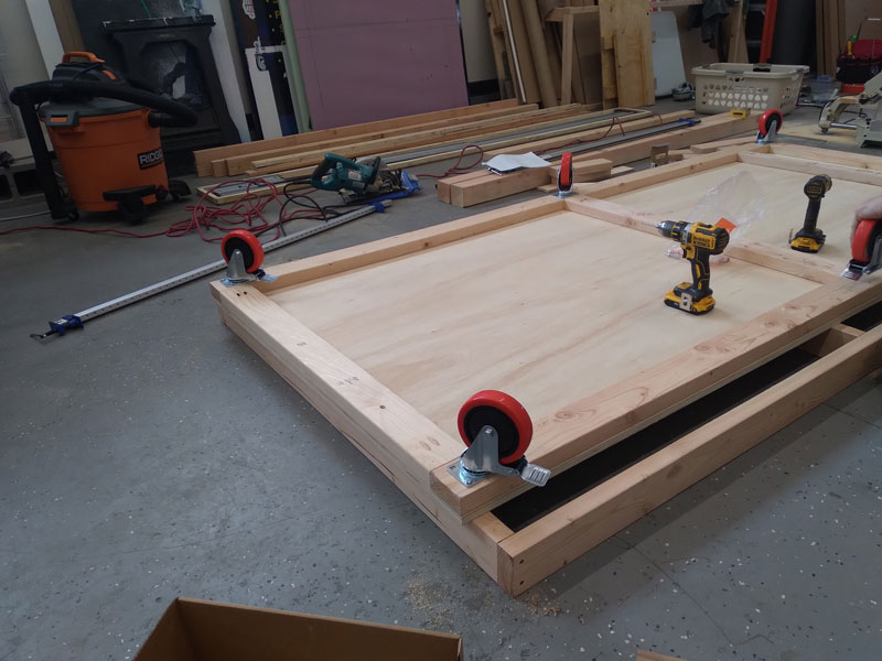

Finally got my 5x10 table painted and topped with a sheet of red Formica. I dismantled the saw track holder along one side and will figure out a better solution. Gino mentioned not needing six casters, but the person I hired to build the table recommended six and there's also six in the build plans posted above. My 4x8 table only has four casters.
Reactions: 3 users

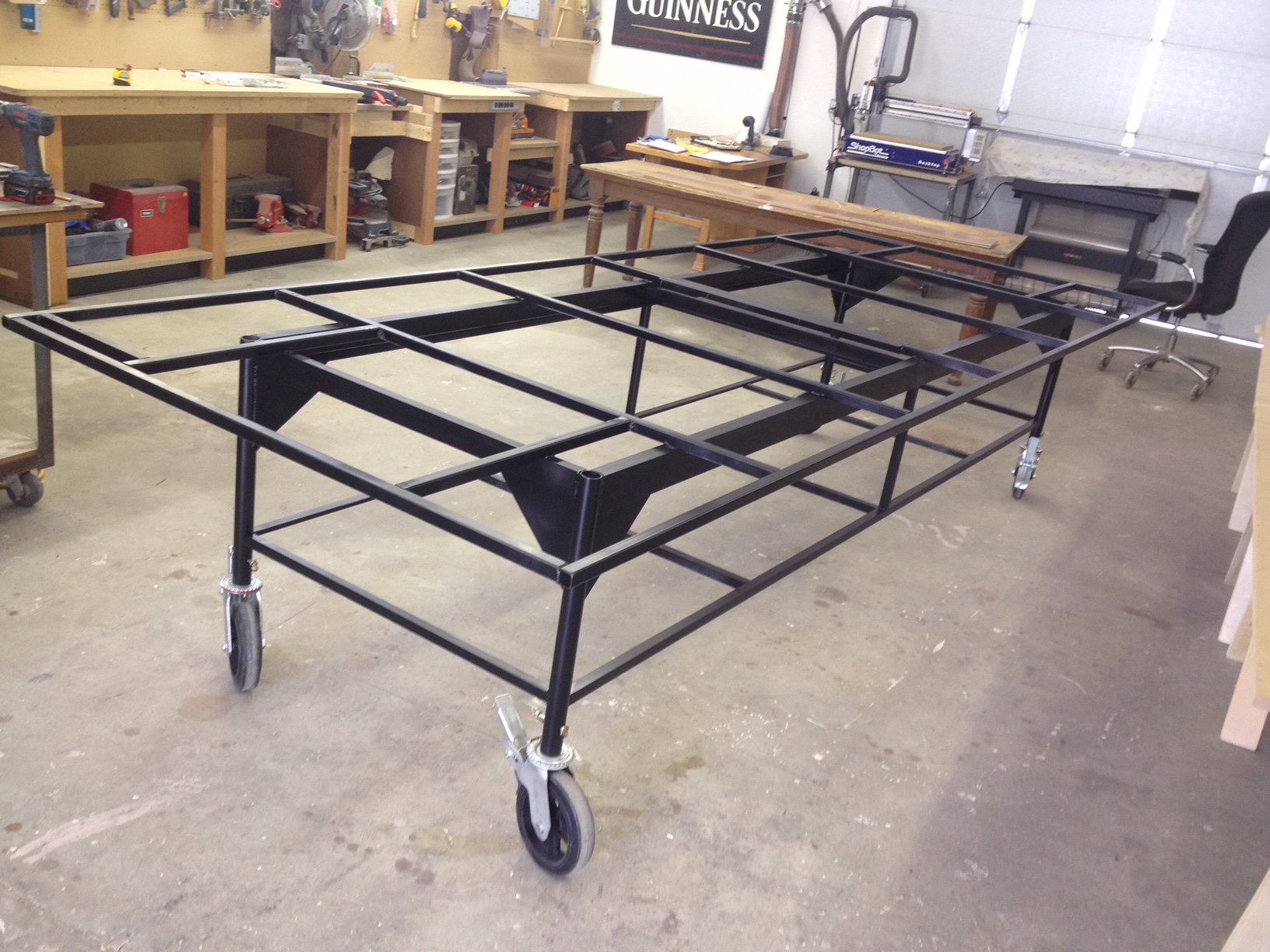

I built this table several years ago. All welded steel with locking scaffold wheels. The main rails are 5" channels which keep it perfectly flat. It's 5' X 12' and has been fitted with a 1" MDF top and Rhino self-healing mat. We then mounted a 12' Keen Cut Evolution benchtop trimmer to one side. It rolls extremely smoothly and the wheels lock down with zero movement. Thinking about adding gutters to the sides to hold long rolls when cutting. Used some old sign panels underneath for a ton of storage. Happy to post a photo of the finished table with the cutter attached if anyone is interested.
Reactions: 3 users
Looks sturdy enough that it could also be used as a frame rack for collision repair.
