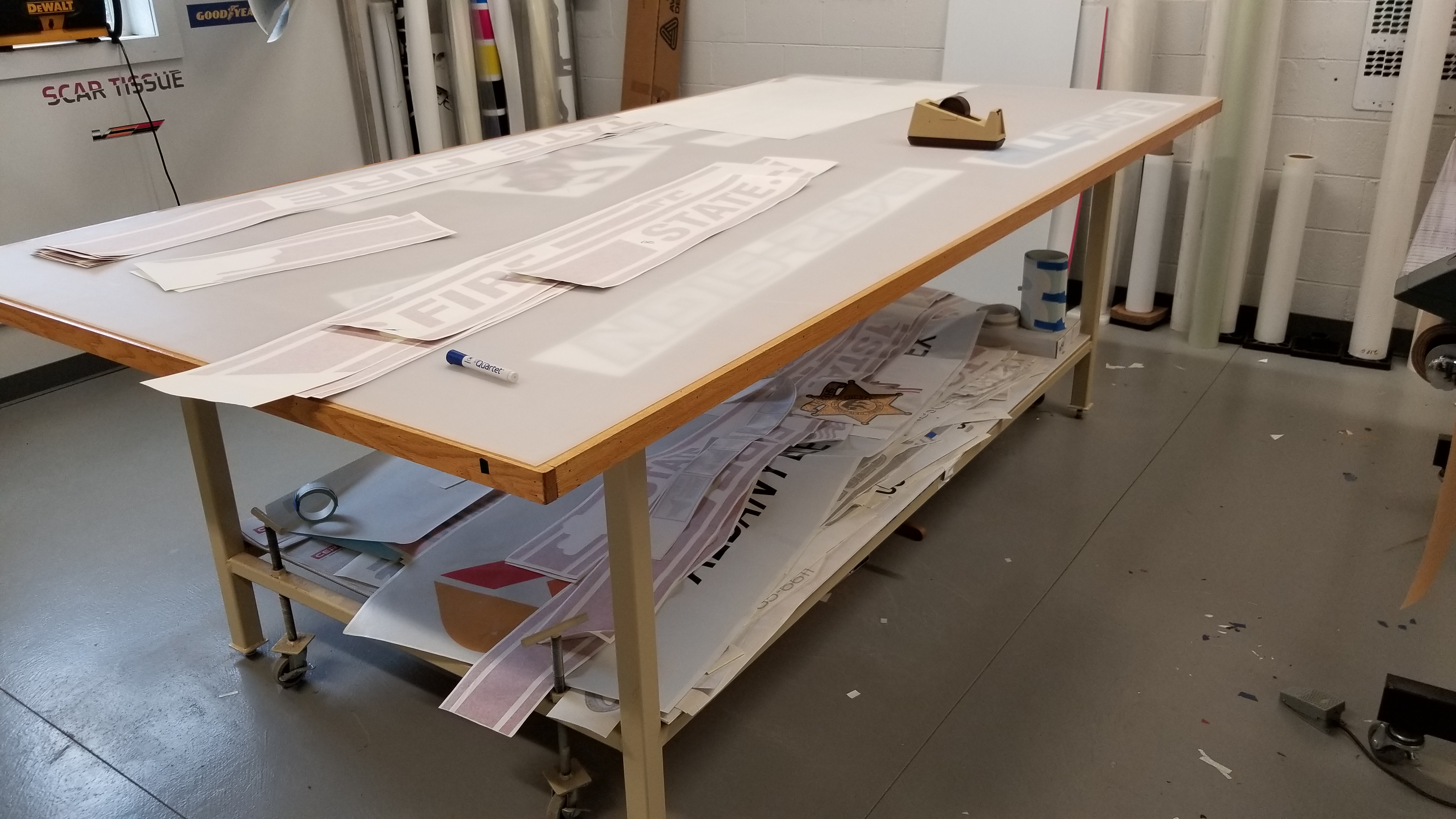

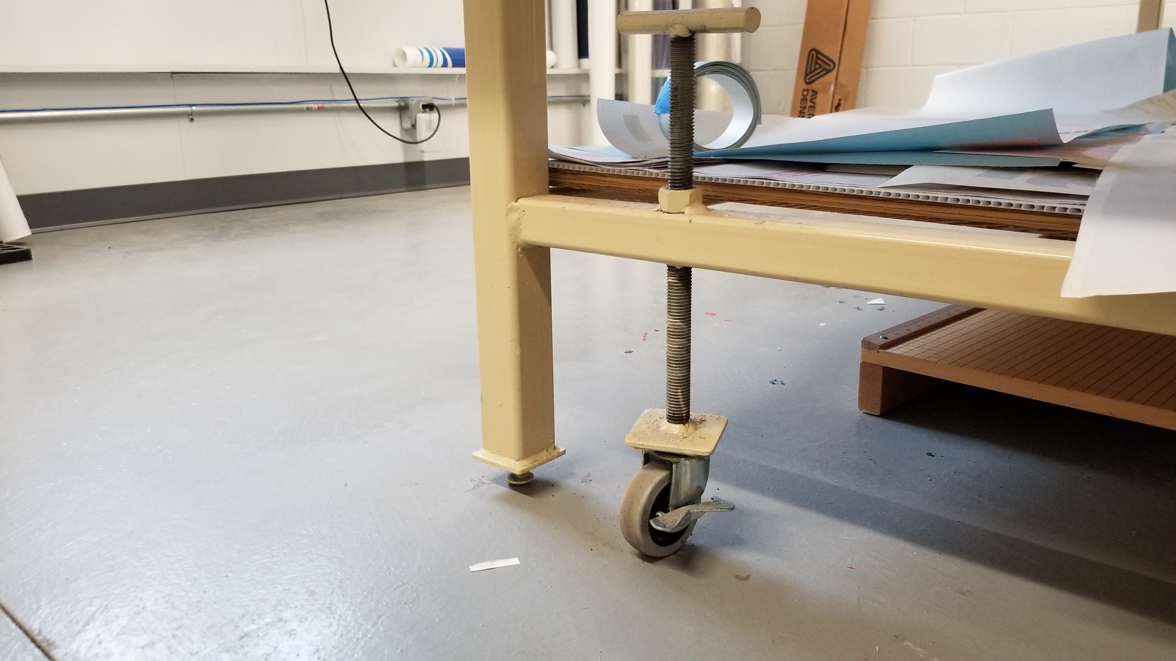

This is one of the ones we made, 2" and 1" steel tubing with 2 sheets of 3/4 plywood top. Adjustable feet and threaded rod welded to the casters. Its 5'x10' cutting mat get replaced roughly every 18 months.

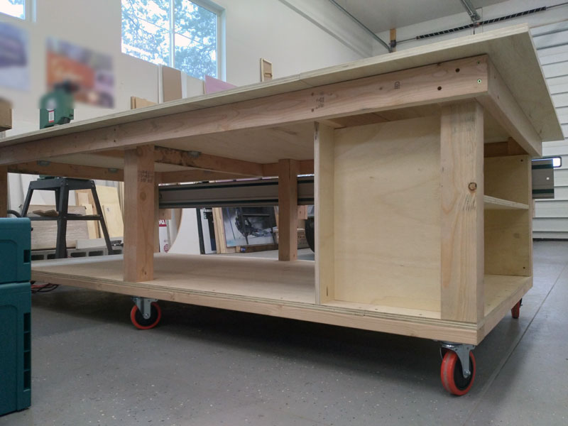

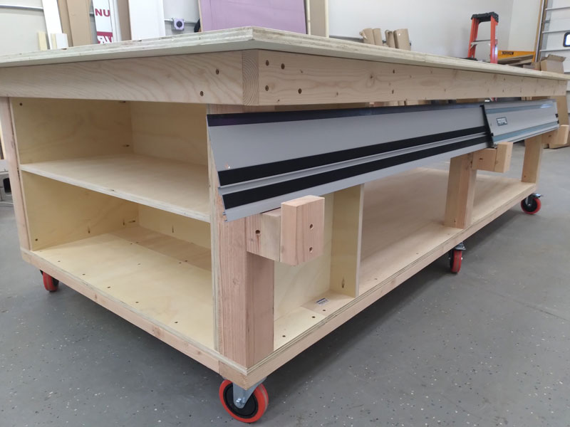

New shop table time! This is a 5x10' with shelving on one end for tools and brackets to hold saw tracks along the side. I want to put some kind of material on top for a work surface, not a cutting mat because this is primarily for doing dirty work like cutting panels, painting, etc. Did it all myself...made a phone call, found a handyman, took a few pictures of it being built, paid him... Turned out nice!

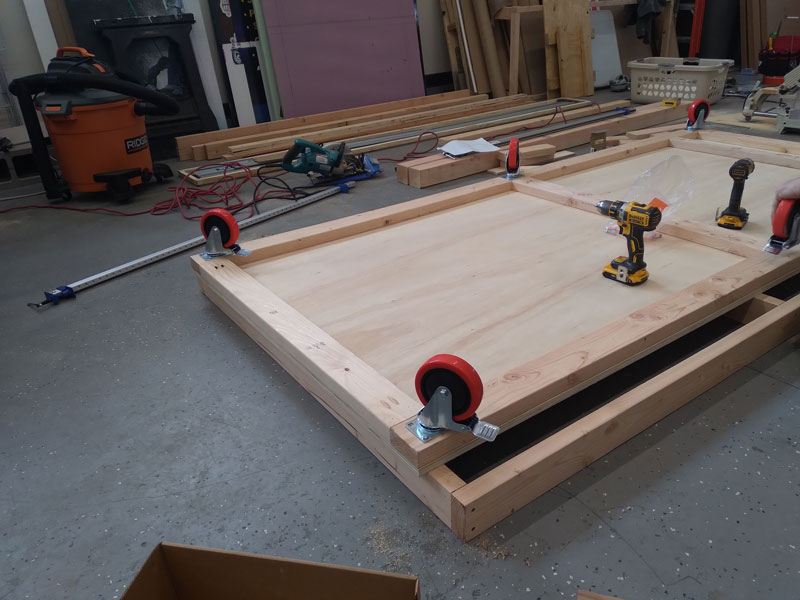

Do you have any other pictures? Post the pics taken during the building of it!
Is it all open in the middle, or is there a support beam we can't see?
I just re-read your post... I thought you made it, but you had someone make it for you?
gnubler
Hired someone to build it. It would have ended up like a Dr Suess table if I tried to make it. Guy knocked it out in about 8 hours and did a great job, I love it! Here's some shots showing the underside so you can see how it's supported.
