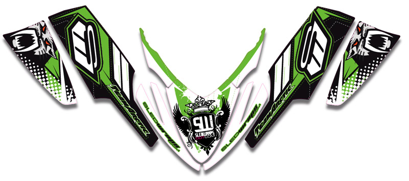

Does anyone know how to do the dot gradient that is on the outer edges of the image attached? does it invalve a gradient? we have 17 snowmobiles to do for a race team. and 2 full size semi wraps by thanksgiving :covereyes:

It is called a halftone effect. Easier to do in photoshop and there are tons of tutorials online for this.
A vector version would not be as easy. One possibility is to do a very, very hi res photoshop version and then run the resulting tif/psd file through an autotrace. The circles may not be perfect, but may work for your needs

vector doctor, would you be able to entirely recreate something like this?
or just basic vectors?
The Vector Doctor
Chief Bezier Manipulator
No not from this. The sledwraps is too small as is that winged shield image in the middle. Not enough resolution to see what is going on when you zoom in
The Vector Doctor
also, this is likely a design created by teamarctic and copying an entire design like this could get you in trouble. Recreating a logo to put on a banner is one thing, but to grab an image from a website and recreate their design is infringement

Ya we are just looking to incorporate the halftone look into our design looking around the internet for some design ideas adn stubbled across this. ty

I recognize that graphic... my buddy from HS did that, his website address is right in the middle there.

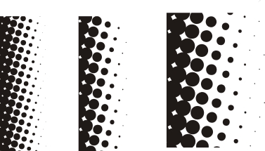

Just created this in 2 minutes using 2 circles of different size and the blend feature in Flexi.

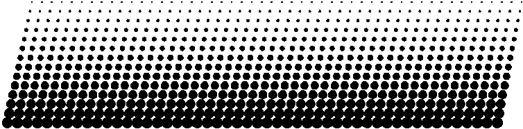

ok so i found halftones in PS but it does just a solid dot pattern no variation in size. can some one help me step by step how to make the pattern? do i need to start with a box or what?
Graphics2u
Google tutorials on halftones in photoshop and you'll find alot. Easier to see it done that way than to have it explained like this.
Need to use a gradient to get the different size dots.
