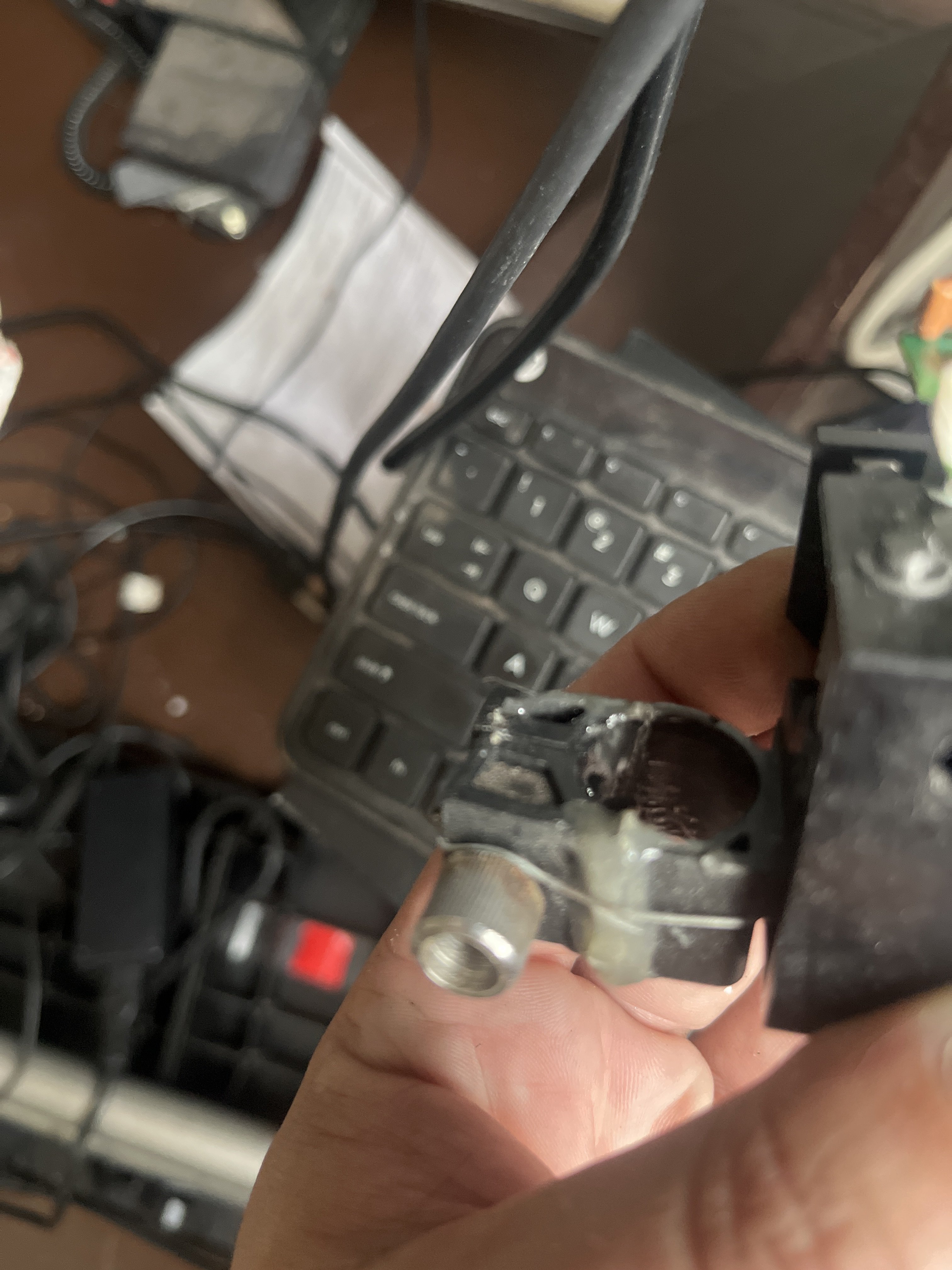

Hi All,
I am looking for Summa Drag Head (Spare Part), Anyone here knows where to buy?

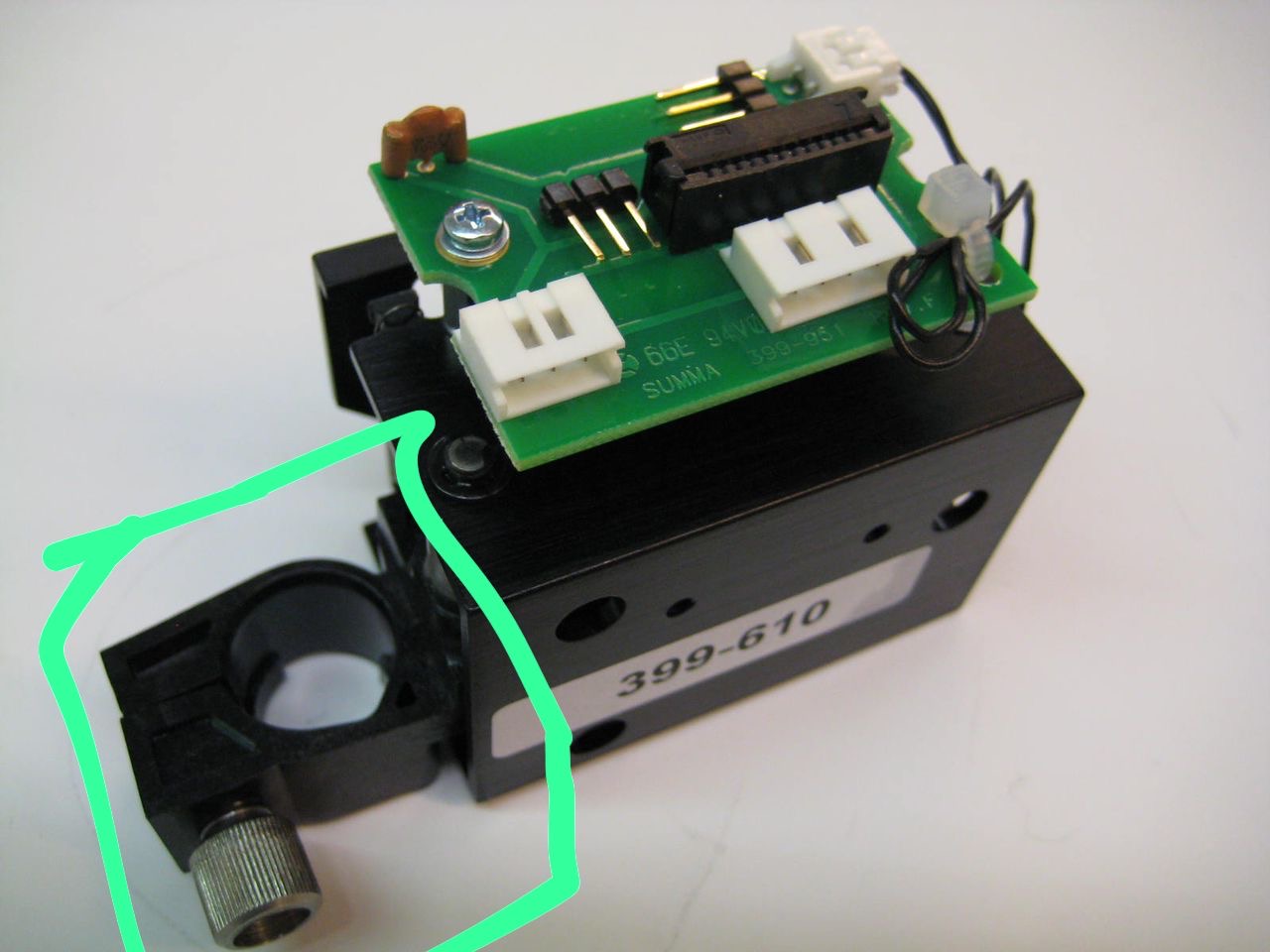

Anyone can confirm the blade holder with mental screw (left) Is seperated part (fastened with screw) from the body?
FrankW

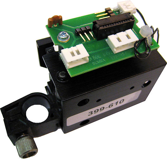

The first adress for summa spare parts is a summa dealer. The tool holder part is not available separate from the body.
PHILJOHNSON
Sales Manager
We(Airmark) have the 399-610 cutting heads in stock. The bracket that holds the blade holder cannot be purchased separately like Frank mentioned, so you would need to purchase the entire head if that bracket is busted. I have had customers glue the bracket back together as a temporary fix, so you might try that if you don't want to purchase the entire replacement cutting head.

Thanks Phil for reply...
Haha..glue? Seriously? What type of glue..perhaps I need to have a try..for temporary..
By the way can u share the price of 1 set draghead?
damonCA21
If it is the plastic part that has snapped then plastic welding should fix it. If you arent confident doing it yourself then you should be able to find somewhere locally. A lot of motorbike repair places do plastic welding. You can also reinforce it with small metal bars plastic welded into the part and it should last fine
damonCA21
If you are really stuck as I know you have been looking for a while, I can get it done in the UK for you if you sent the part here
