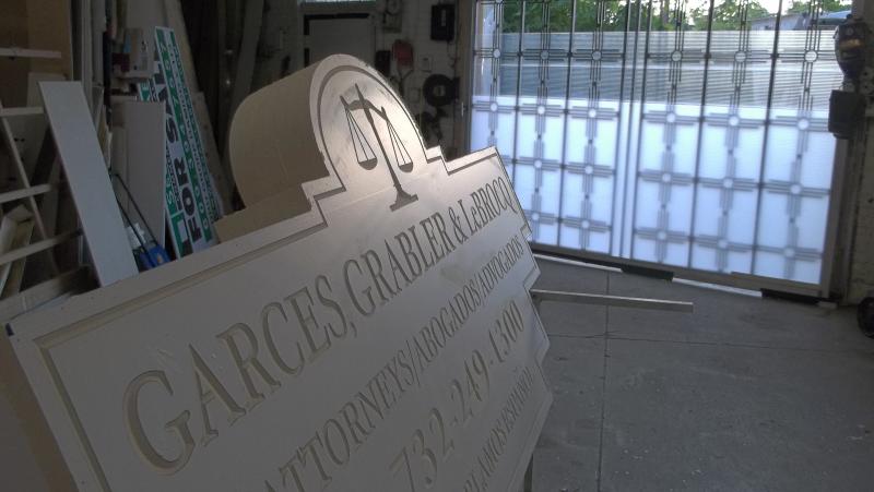

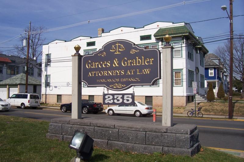

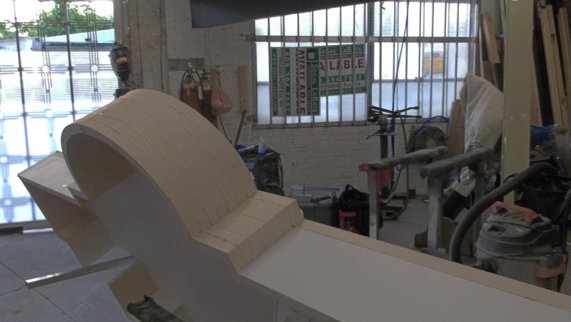

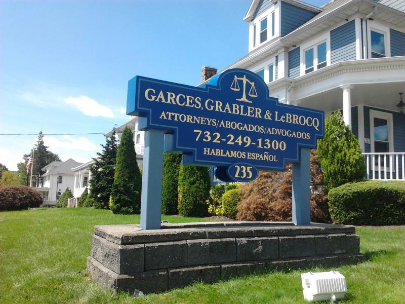

Here are some before and afters.
They sent us the copy which we could not edit.
We put it into a shape made a box out of it to sleeve over the old existing posts.
We used 1" 15lb sign foam.
We painted it ,masked it ,v carved it ,glued it up , gilded it and installed it.
