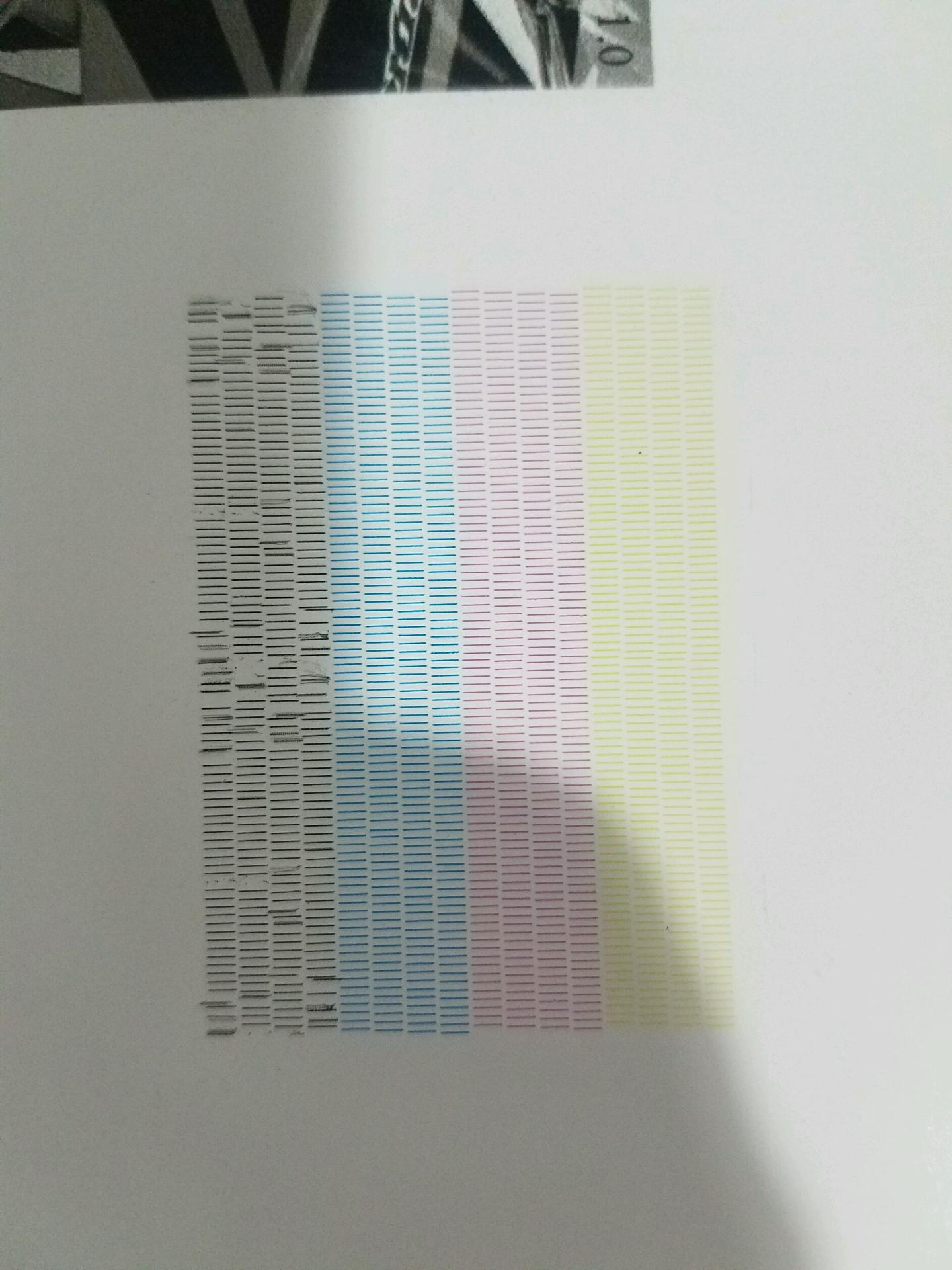

Well I couldn't go see it because he had to replace a bearing to get it to print its working again and here is the results of the print head test...
What do you all think?

GAC05
Quit buggin' me
Looks like the black channel is toast. You might be able to recover it but most likely you'll need to get a new DX4 head.
Not sure what the going rate is but you will want to get an OEM head and I think they run around $700+ USD.

Maxon70
wayne k
guam usa
How would you recover it?

The guy wants 3300 for this one and it has alot of new parts here is his description --> "has new ribbon cable, new scan motor, and new caps replaced and serviced by Wensco. Comes with new 220ml ink cartridges installed, Versaworks software, original (still working) scan motor, owners manual, all new bearing blocks for both carriages recently installed" sounds like it was a money pit for him, but its all replaced now..:) except for the black head of course..
Signchief
Why would he go through the the trouble of replacing all of those parts and then throw in the towel over a print head? That's a red flag in my book, if all it needed to be a functioning unit was a printhead you'd think he would replace the head and then sell it for a bigger profit... If the seller doesn't see the sense in investing any more into the machine then why would you? If it is worth 3300 as a paper weight then I would think it would be worth double if it was working like new, they must not think it's worth fixing.
