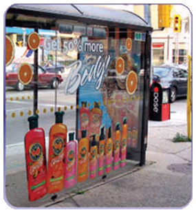

I can print white,but its weak and not viberant, here as the attachment, is what i want it to look like.

If the art is like what is in the pic you posted, why dont you just print and contour cut to shape?

your post says that you can print white. if it's not opaque enough 2x print the white, let it dry, 2x one more time, let dry, then do the color file. simultaneous white printing isn't all it's cracked up to be. ...the image of the bus stop looks like a super easy project for a white/color ink printer.
