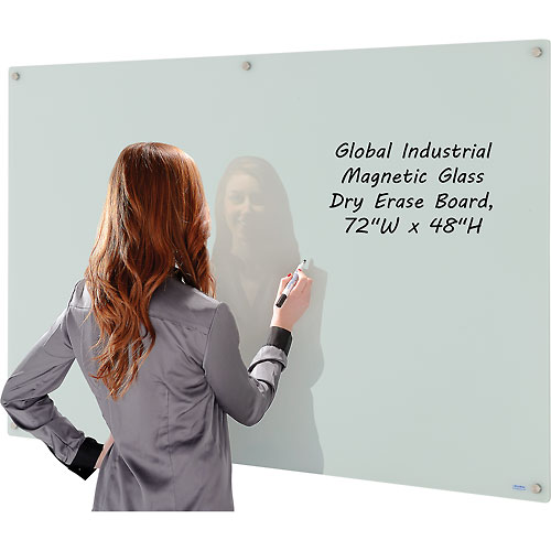

I have a customer that wants a glass dry erase panel, that is magnetic, with an image printed 2nd surface with a white background.
What is the best way to go about making this? I have a flatbed UV that can print the image on the glass, then I floodcoat the glass with white paint? Would 1-shot white work for this?
Then I am thinking I can apply magnetic paint on the back of the white paint. I haven't worked with glass much, I'm just not sure what all this paint on it will do and if it will stick well.
Normally we spray Matthews, but I think that will mess up the UV printed graphic.

This is a new one for me. Why or what's the advantage of a glass magnetic panel ?? I would imagine the uses are limited, due to the high breakage points of glass under certain conditions. Other than aesthetics as mentioned, why ??

Ever see a new dry erase board after heavy usage?(like a classroom) They start to stain/ghost, and glass is impervious to this. More expense up front, but you'll never replace them.
Smart Boards are better yet, although without the magnetic capability.

I tried a piece of 26ga steel behind 1/2" thick glass. There is some magnetic pull, but not a lot. I'm guessing that is why the ones you find online are so thin (the only one spec'd I could find was 3/16" glass). My glass guy recommended no thinner than 3/8" for as large as my customer wants to do (48"x72") so it doesn't flex when writing. I think I am going to tell my customer these are the options:
- Glass, no magnetic
- Typical dry erase board, with magnetic

But if you combine your steel sheet with your glass so that the total of the thickness is not bendable. Would it work?

The steel sheet would give a little bit of strength, but not a lot. I'm not fond of thinning the glass. It would defeat the purpose of this - to look high-end and be very durable long-term. I think I'll try a little thicker gauge of steel and see if that helps.
