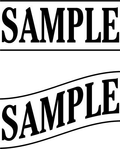

Now how would you do it for lets say text with a thin line above and below the text that flows with the lettering though?
The Vector Doctor
Chief Bezier Manipulator
When you create a path for the text to follow make sure you also create stroked lines above and/or below the text. That way when you apply the distortion/envelope tool, make sure both the text and lines are selected so all are distorted/curved at the same time. Alternately you can go in by hand and draw a path that follows the curvature of the text

example

The Vector Doctor
I don't recall the options in v10, but my sample was done using the envelope distort tool. Text on a path generally follows the path and will not result in the vertical sides as shown on my sample. Even in newer versions of Illy will not produce these results when using text on a path. You must use the envelope function

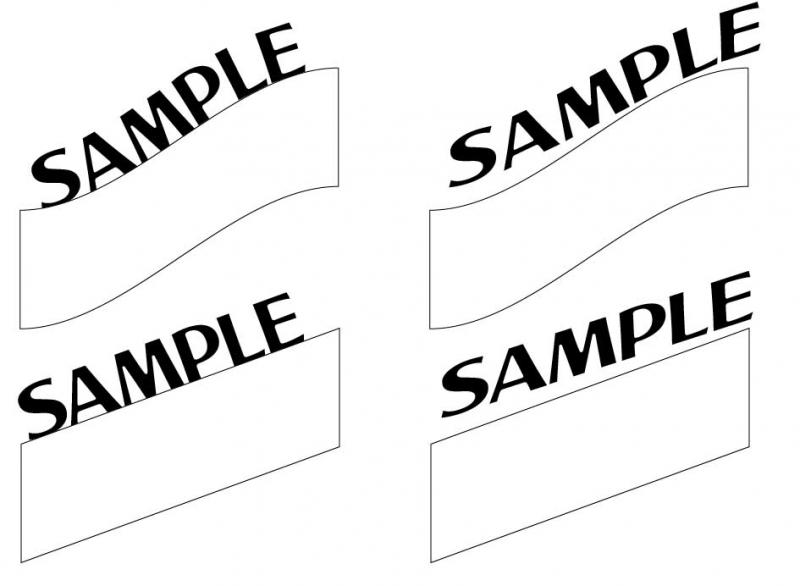

Malkin
With the text selected, can you go to object>transform>shear?
The 2 on the left use the Path Type Tool, the 2 on the right I applied a 20 deg. horizontal shear. It sort of works for the straight line, but not so much on the curved line.
I still need to play with the envelope function...

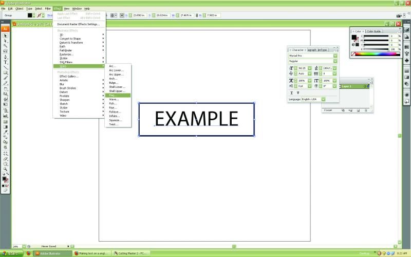

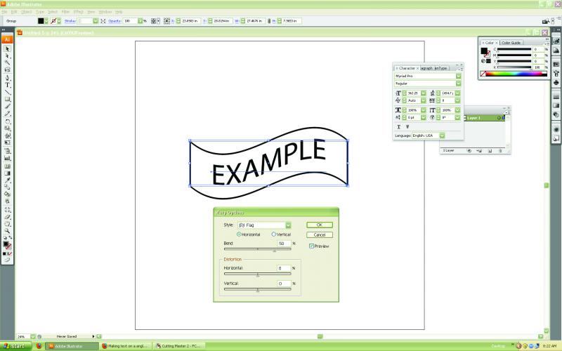

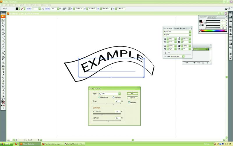

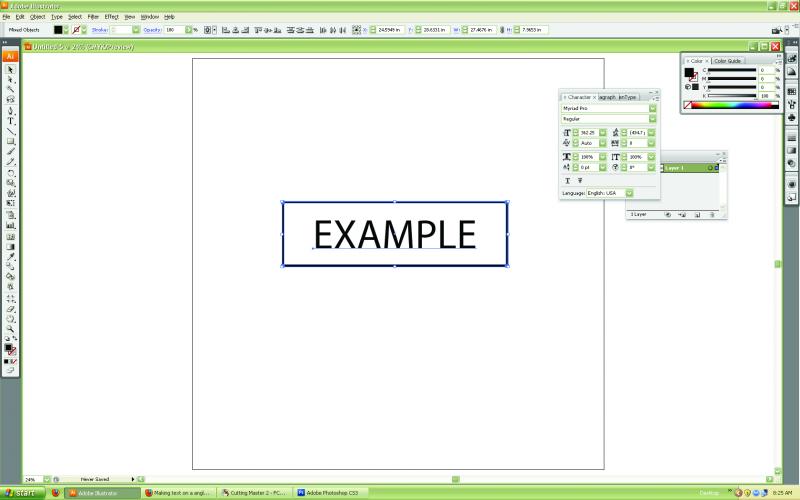

cartar929
You don't really need to type on a path. There is another way to do it.
This is in Illustrator CS3
1. Create your type and whatever graphic element you want around it.
2. Select it all, and group them together.
3. With everything selected you want to warp go to: effect > warp (then choose the style you want to warp your selection)
4. Check the preview box to be on so you can see how your selection is being effected.
5. Click ok and your manipulation will take effect.
6. You can also warp your previous manipulation to compound effects if you need to.
