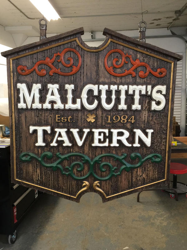

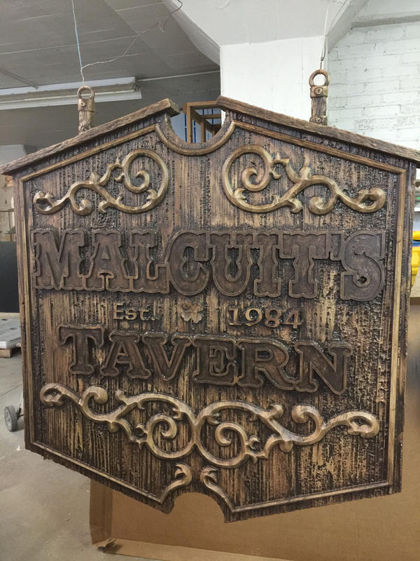

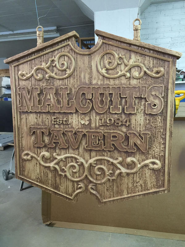

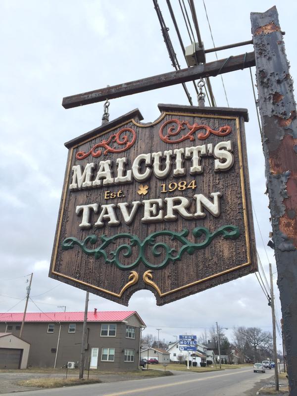

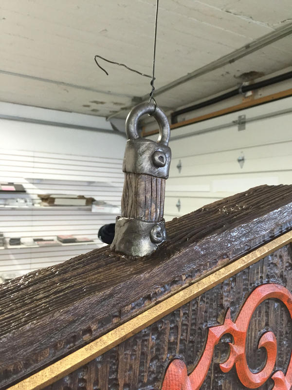

Our latest carved sign. The customer was delighted.
30lb Precision Board
Smooth-on Free Form epoxy clay
Modern Masters and Sherwin Williams paints
Carved on our Multicam 3000 series CNC
All programming and modeling done in Enroute PRO 5
