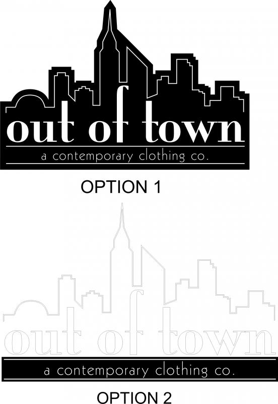

I have a dilema. My client wants rear-lit letters with this logo. he also wants the city scape to be lit as well as the lower tag line. We proposed a cabinet sign to look like the top drawing. response was anything but positive. I have been told by multiple channel letter guys that the stroke is too small to back light. anybody have alternative options to suggest? Thanks for looking and replying.

first thought of mine would be to do an acrylic sign face routed to shape, cover it in black vinyl to block out that you want black letting the white show through
make standoffs to hold it out and have lights, LED or whatever behind it, makes the letters glow and will do a halo effect around the sign for the most part

Aluminum Can, CNC routed aluminum face, fabricated aluminum retainers, LED lighting, push-thru acrylic lettering/logos.....We're making some like this right now. I'll PM you with my info for more details...

seriously I would do an all black face and stroke the outline of the city thicker and then the lettering like in option one, he cant have his cake and eat it too. what hes asking for is not reasonable if Im reading this right

This... looks like a pretty straightforward job to me. You need to find different channel letter guys.

yep - thats the way to go. It is way to small for channel letters but they should have given you some suggestions. Malls are usually very picky about the signage with strict requirements so you probably dont have that many options.

First things first! According to the LEASE, what is he allowed to do; NOT what he THINKS he is allowed to do; or what he THINKS they SAID he was allowed to do
