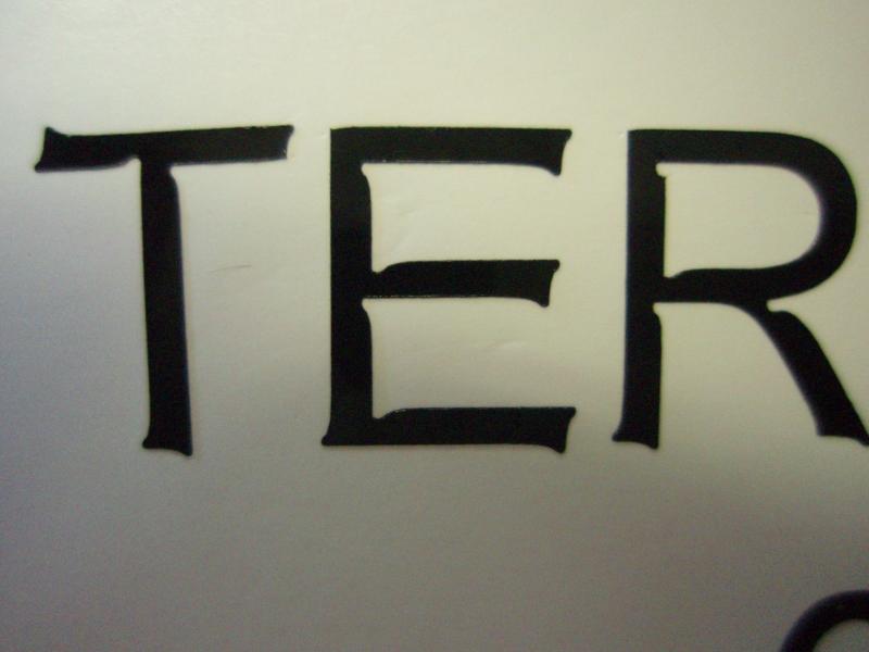

Actually they`re JUNK... but I got your attention. Can`t wait for my Gerber to get here so I can take this thing to the shooting range but until then I have a job to do. My problem is I`m doing 1/2" lettering on some small wall tiles. When I cut it`s leaving small curves on the insides of the letters when it should have sharp corners. The only thing I can think of is it`s where the blade is rotating to make the curve but would like some other input. I`m using Flexisignpro and a desay master XY380P cutter. I`ll attach a pic so you can see what I`m talking about. Thanks and PLEASE HELP!

Is the Knife or carriage loose? It looks like the blade overshoots in the direction of travel before being brought back on to the correct line. It could also be knife offset .... May be

You've just invented a new type-face....BIG BUX there! Woo Hoo, do you know what a GoldMine you've got there?!
Yikes, looks like it's either a serious mechanical flaw or there is some sort of software offset that's clearly outta whack.
Thats exactly what it looks like.....Everything is tight on this thing though. I`ve done bigger signs and it works perfect but have never done anything this small.

Take the blade holder out and soak it in mineral spirits... let it soak for about a hour them blow into it to get any dirt out. We have a master and graphtec but still use the master...I guess we got the only good one...but the loudest one i bet...

So what exactly solved the problem? Was the knife offset wrong or?
Yes the knife offset was wrong (which I changed to 0.012) The curve quality was on high when it should of been low or medium and the packet settings were at 8KB instead of 1000 KB. What a difference! I`m might just keep it as a backup instead of using it as target practice. Thank you for answering my post and of course to sandrailgraphics for initially posting this! You guys are great. Cheers
