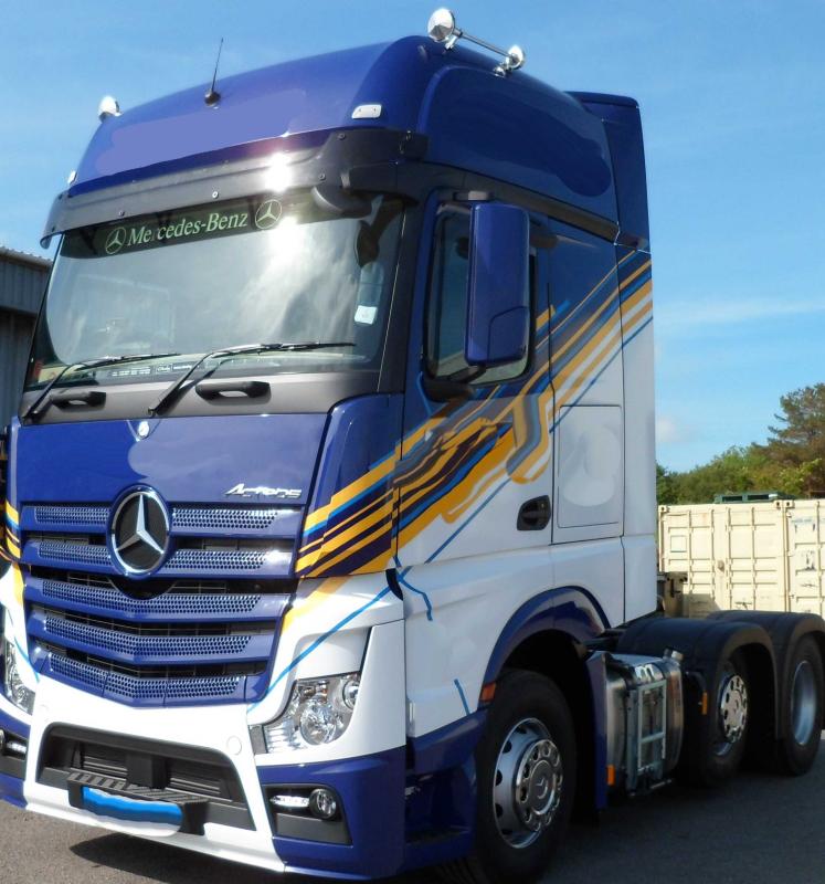

WE just completed a fleet of these wagons.
The trick is to either not let the two colours meet or change to print at a join (doors/panels).
It took about 8 test prints to get near to this colour.
Also it was printed on a very high quality print setting.
