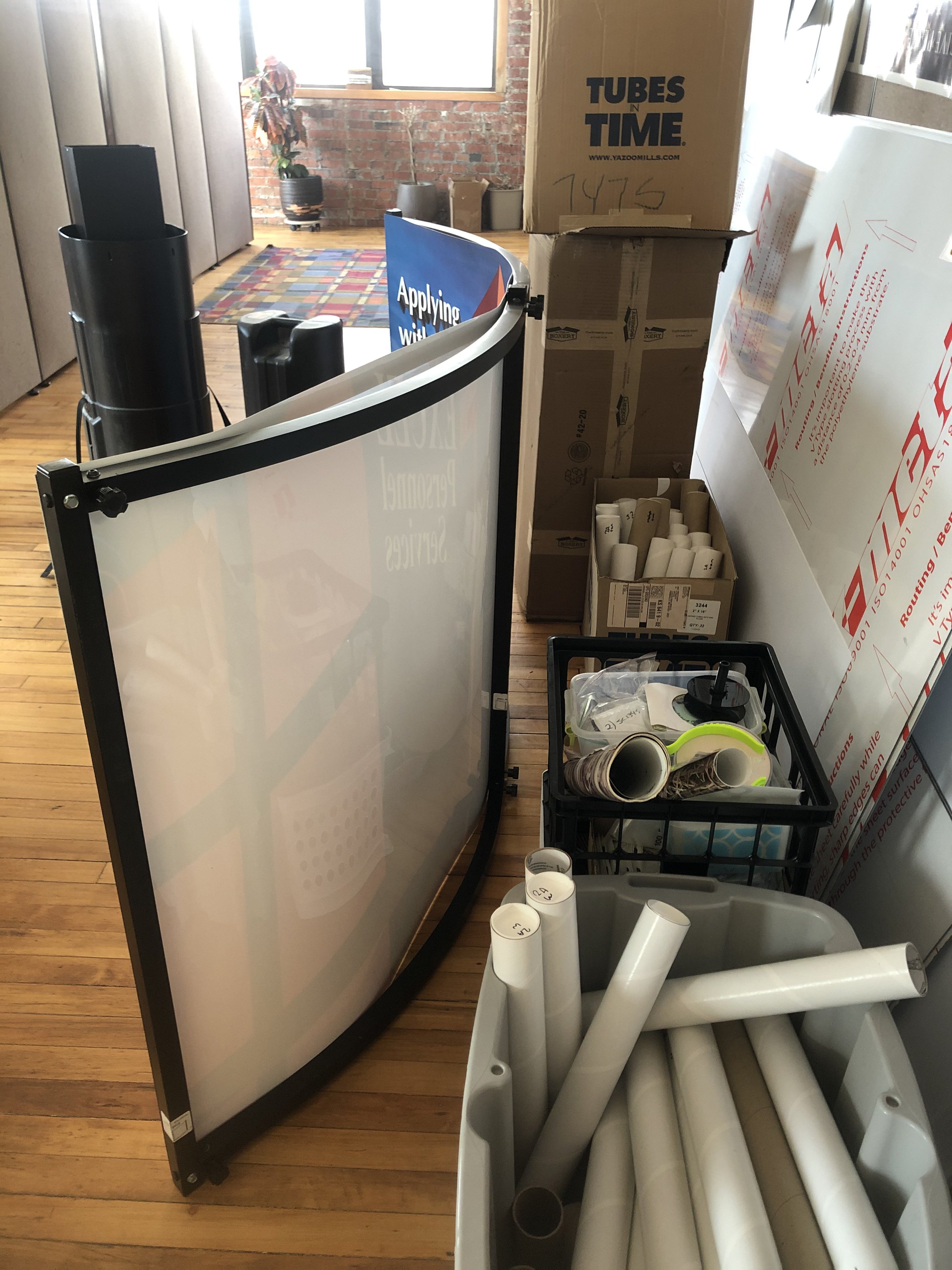

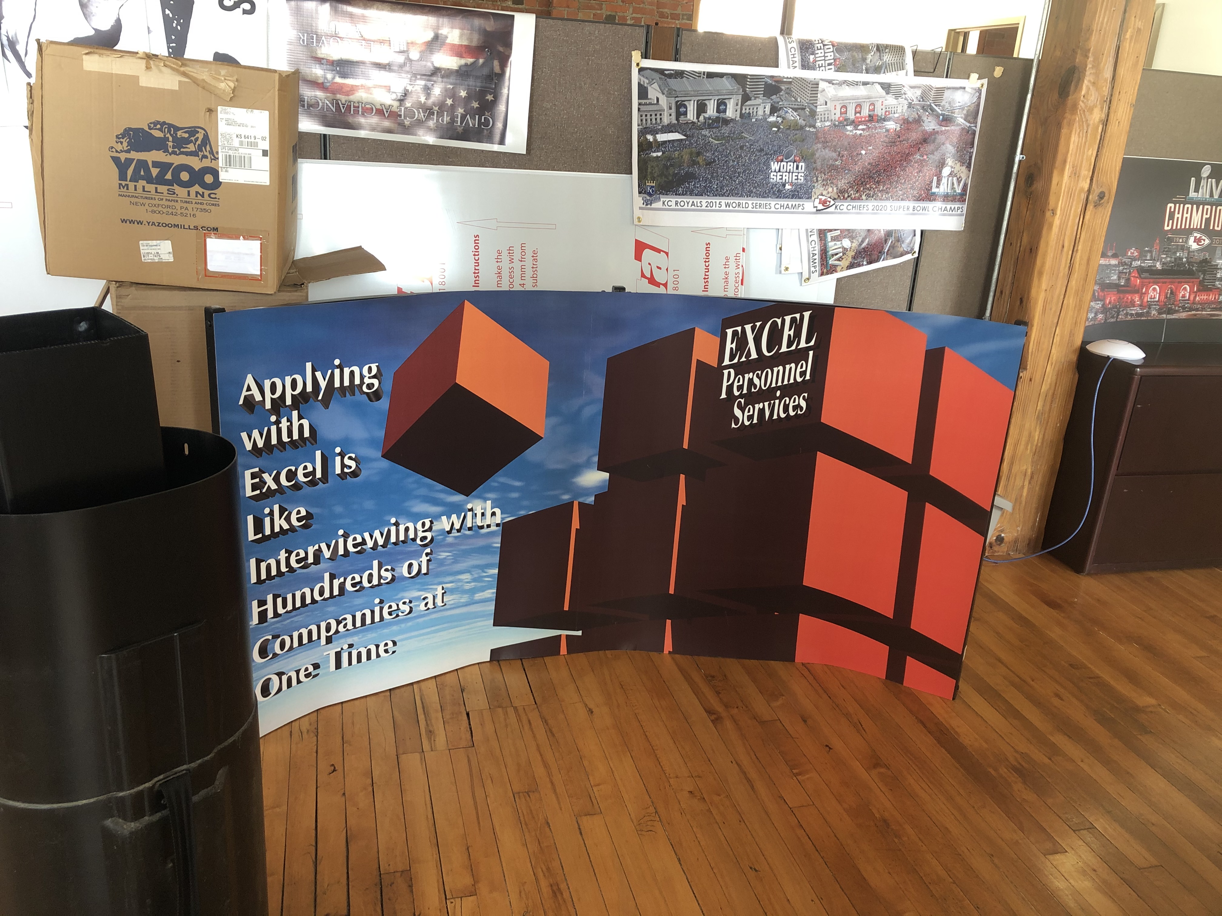

Can someone tell me what type of material this is or what type is generally used with this type of curved display (photos should be attached)? Appreciate it!

I would think polystyrene or foam pvc would be ideal for that type of display. In the photo, it looks like a banner but if it was a banner I doubt you'd be asking so I'm gonna go with polystyrene. Is it somewhat rigid?
MikePro
that would be in the semi-rigid film category, either PVC, PET, polyester, in the 8mil+ range. Polycarb is even available at .030" (...40mil?), possibly thinner, that you could roll it up "easily". Secure it with velcro or dbl. sided tape. ezpz.
Lindsey
Not A New Member
It looks like styrene. But styrene is usually opaque. In the photo of the backside, the material looks like it has some translucency. Perhaps for backlighting.
MikePro
i'd think you'd want opaque anyways, or at least barely trans., else lighting would cause you to see the shadow of the framework through the material.
signheremd
That looks like .030 polycarbonate. Most often we use PET banner material which is a "rigid" banner that is still flexible enough to be rolled up. Usually UV flatbed print, sometimes laminate, and velcro it onto such a frame. Hope that helps
Call your distributor and ask them if they sell display header material. It usually has a pebbly type finish and is good for backlit or opaque usage. Works best when you letter in reverse on the backside to prevent glaring from lights and other reflections. It is some sorta poly material. I think what we have is .020 and clear.
Steenland
Old Member
It could be a print that has been encapsulated between an overlaminate and a 10-mil backing material. I used to produce a lot of trade show displays that way. (Except that the backing material was opaque.)
