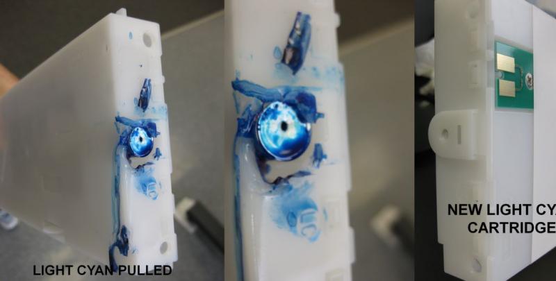

I am running a Roland SolJet 545 with ecosolvant inks and we pulled out a light cyan ink cartridge to find that the end had been melted.
has anyone ever had this issue.
Any insight would be appriciate, solution cause, anything!!!
Thanks guys Attached is a picture.
Jack Knight1979
I assume that is a non OEM ink.
Non OEMS are more aggressive and could melt the carts.
That's a first for me though. Did you do something weird to that line when you changed a damper or something like that?

Yup guy came yesterday and stuck a flashlight in the print cartrige slot and said thats wierd everything looks fine. We will send the cartridge to roland at end of the month. And left....brutal. Didnt help us any.
BobbyFosson
If the bag inside the cartridge bursts, or the orifice is damage and causes a link, the solvent will melt the plastic... I have had returned cartridges (Roland OEM, Triangle, Etc) come back with nothing but ink and the chip in the sealed outer plastic packaging bag...
