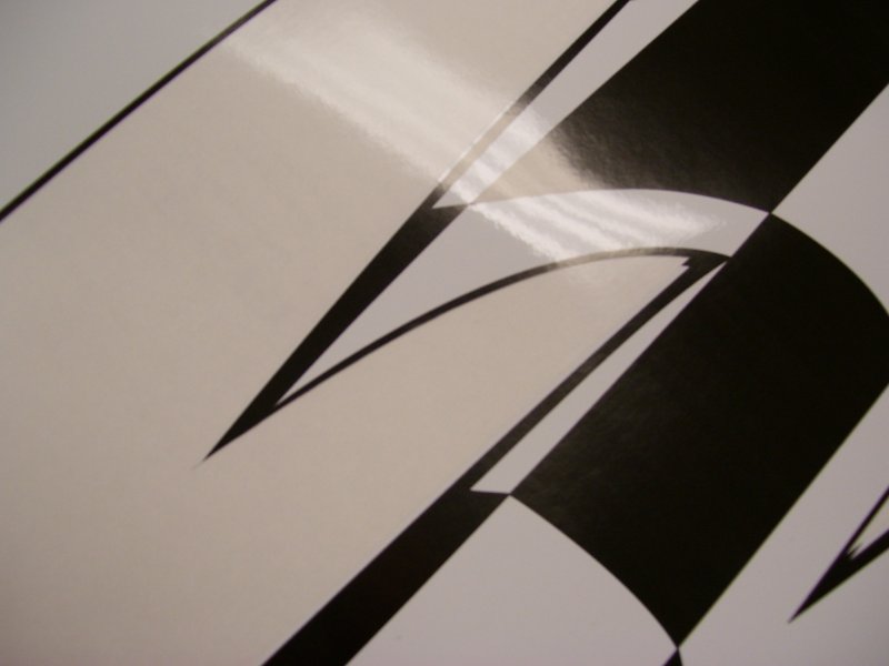

Ok, don't know if you can tell in this picture that well...but what I'm dealing with is that anytime I have to cut anything longer than like 3ft. my stupid cutter won't cut along the line. This was an 8'ft long run. I haven't EVER been able to do an 8ft cut that well in the 2 years I've had the machine, but it's just getting stupid now. Anyone have ANY ideas on this. I just don't see how it can skew, ESPECIALLY when it's compensating by finding the crop marks. Sometimes I can get away w/ a bleed, but couldn't do that on this project. Even then, it'd have to be a 10 - 15 pt. bleed sometimes.

We have a 160 FX that works great including contour cuts. Before this one, we had another Mimaki for 12 years or so. It still runs great.
TheSnowman
This is a 130FX I believe...if that's what it is. Something FX sounds right. I've never had 100% success w/ it, but several other mimaki owners say they have no trouble at all.

I've never had a problem on even much larger runs. Try using larger registration marks, and slowing the detection and cut down a hair.

Are you doing your contour cutting out of Onyx or the Finecut plugin for your Mimaki? If you are having registration issues with Onyx, then I would try the plugin Finecut(which works out of Illustrator or Corel) for your Mimaki plotter. Mimaki plotters and Cut Server tend to have issues...

I really hadn't thought about trying it w/ FineCut. Actually, I'm really not even sure how to go about doing that. How do you tell it find the registration marks? Do you just set the plotter like you normally do for CutServer?

Shoot me your email and I have a document for full directions on setup and usage for Finecut. It's easy to do...

I would have to agree that Anything beyond 8-10' it becomes extremely less accurate. When the plotter detects the registration marks does it adjust where it cuts after the detection process?
I cut everything except prints from onyx using finecut, but i cant seem to find out where you'd enter the code, or load the xml file.

Use fine cut and use 10mm marks. When the marks are smaller, the detection tends to suck. Also, set the mark detect speed slower. If the blade point isn't bullseyed over the origin registration mark after the detect, your marks are too small for the size of the job, or your detect speeds are too high and you'll have problems. We just did some 15 foot long pieces no problem.
Most of the complaints seem to be from those using flexi or onyx for their contour cutting. Try fine cut.

Also, call your tech support (I bought mine from Grimco and they are great). My technician walked me thru a couple of tweaks to the on board settings...
1. Slowing the head speed down
2. There is an option on the pinch wheels to increase the grip pressure (little levers on the back)
3. change electronic eye to look for only 1 (lower right) registration mark
4. Use FineCut software settings to locate the four registration marks when sending the plot data
Long story short, our Mimaki has no trouble at all now and regularly runs 15'-20' projects with excellent precision.
