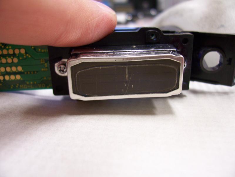

You definitely have a damaged head. The print head hit something and no soaking is going to bring it back. Unfortunately you will have to replace the print head, I have seen this 5 or 6 times before on the JV3. It is hard to see with the print head in the printer but once it is taken out you will see scratch marks on the nozzle plate, similar to the ones in the picture that I have attached.

i'm always rootin' for the head to be salvageable! Soak it and post pix of the improvement... or lack thereof.
